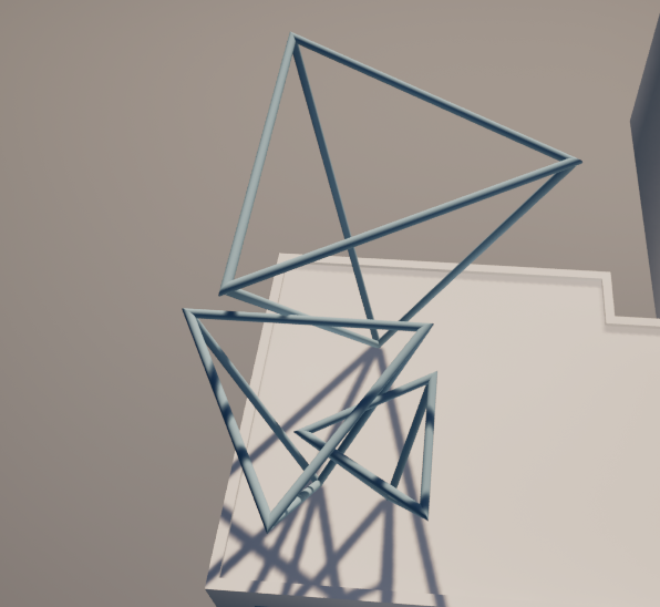

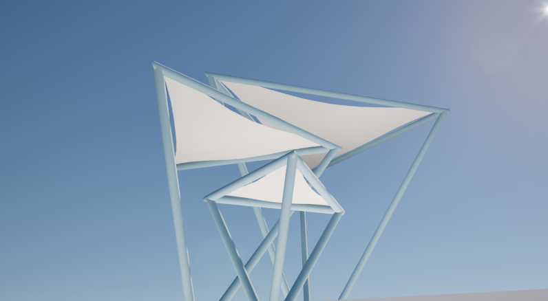

I got a problem with the visualisation of a project.
In the pictures you can see my problem.
You can see the morphs (These are membranes in real life) are only visable from one side.
I tried every way to save the project as .fbx and every way to import it in Twinmotion, but it stays this way.
What can I do about it?

I think you need to tell the material to be 2-sided. Sorry, can’t remember if that’s in the material definition or the object settings (but I hope it’s the material, so you can change them all at once).
Hope this is right and it helps.

Im gonna try that. Altough I dont know if you can do that with a morph.
Edit: Nope, doesnt work. There is no way to tell the morph its two sided.

Not sure you tried it allready, but I think KenMcN ment you should set it up in TwinMotion, not in ArchiCAD. I have had these situations too and I did solve them by choosing two-sided material in TwM for the object.
HTH.

Sorry, thought I'd replied to say that as well, but it must have gotten lost. Yes, the material needs to be edited in TM , rather than Archicad.
