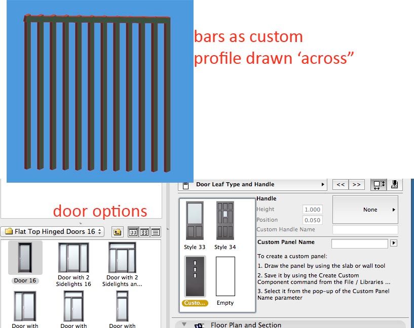

The stall bars are simple to model, but an intermediate skill level is required. Lay the bars out in an elevation as fills and transfer the fills to a COMPLEX PROFILE window. Draw the bars using a wall ACROSS the wall direction.
As for the door: Door 16 has several panel options including a "custom" one. Follow the instructions. You may research also "Creating an object"

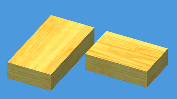

One problem Archicad elements have is that they are improperly mapped. For example, if a panel door that should be modeled with rails and stiles is modeled with a slab, the cross-pieces map across the direction of the grain. Converting to a Morph [Archicad 16] allows surface re-mapping but ruins the schedule.
Mapping anomaly also shows up as direction bias. If you make two slabs, one wider and one longer, the application maps them differently. [attached]
