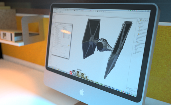

Rafal SLEK
2. We could use also HDRI maps as emitters not only for background but also for Surfaces.
