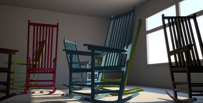

Continuing with the tests. This time a simple scene. Minimum time involved with each program, first up is LightWorks inside of ArchiCAD 10.
Quick to render, easy enough to set-up. It works.
Next up, Cinema4D. The export is straight, some slight adjustments to the colors. 3ds export is the only good method of getting the model data to C4D. The plug-in for AC to C4D has been missing in action for a few years. Without it, using C4D as a rendering solution is a chore.
Final test. This time in Maxwell Render. MR
The export to MR is painless, the plug-in for windows platform is a gem. The file was rendering within minutes. It looked good, so I adjusted the colors of the chairs.
In LightWorks the sun beaming in was accomplished with a fake window light. In C4D the sun was a light placed outside of the window and in Maxwell the sun was defined as a real time and place.
Which one was I most successful with? You vote.

Burginger wrote:
You vote.
I vote for lightworks - 10 hours for a simple scene like that is a tad steep.
It might be easier to compare if all scenes were the same (view angle, materials, window) though.
But keep up the good work...
Rakela Raul
excelent test and thx for sharing it.....
i will repeat exactly what tom norman just said!!
MACBKPro /32GiG / 240SSD
AC V6 to V18 - RVT V11 to V16
Thomas Holm
Tom wrote:
Burginger wrote:
You vote.
I vote for lightworks - 10 hours for a simple scene like that is a tad steep. ...But keep up the good work...
I agree with Tom. LW not only renders the fastest, it looks best! Even if the shadows on the floor feel a little weak.

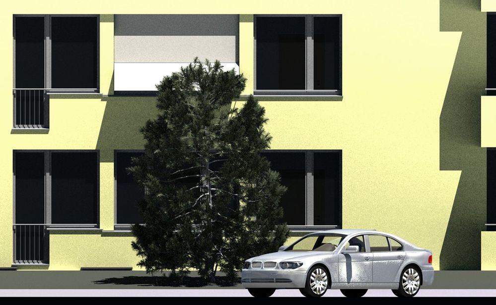

Although they don't look 3D in this C4D planar elevation view, one thing missing from the Maxwell universe is the easy insertion of entourage. With C4D the inclusion of xFrog Plants and trees is an easy process. You can also insert any of the items from Dosch Design, a snappy BMW 7 class is shown here. This is not currently possible with Maxwell.
If there was a plug-in for Mac/PC that would migrate a C4D version 10 scene to Maxwell, then the cycle could be complete. Also needed badly would be a plug-in from MAXON that moves an ArchiCAD project to C4D v10.
I know... that's alot of wishing going on.
