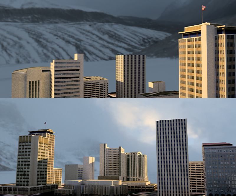

Yes, HDRI can be fun once you set it up properly. Here is San Diego - Denver style.
Model by Planet 9 Studios: http://www.planet9.com/demos_data.html
Nice Renders!
Remember that using HDRI environment you'll cut down render time soooo much 😉
Djordje
