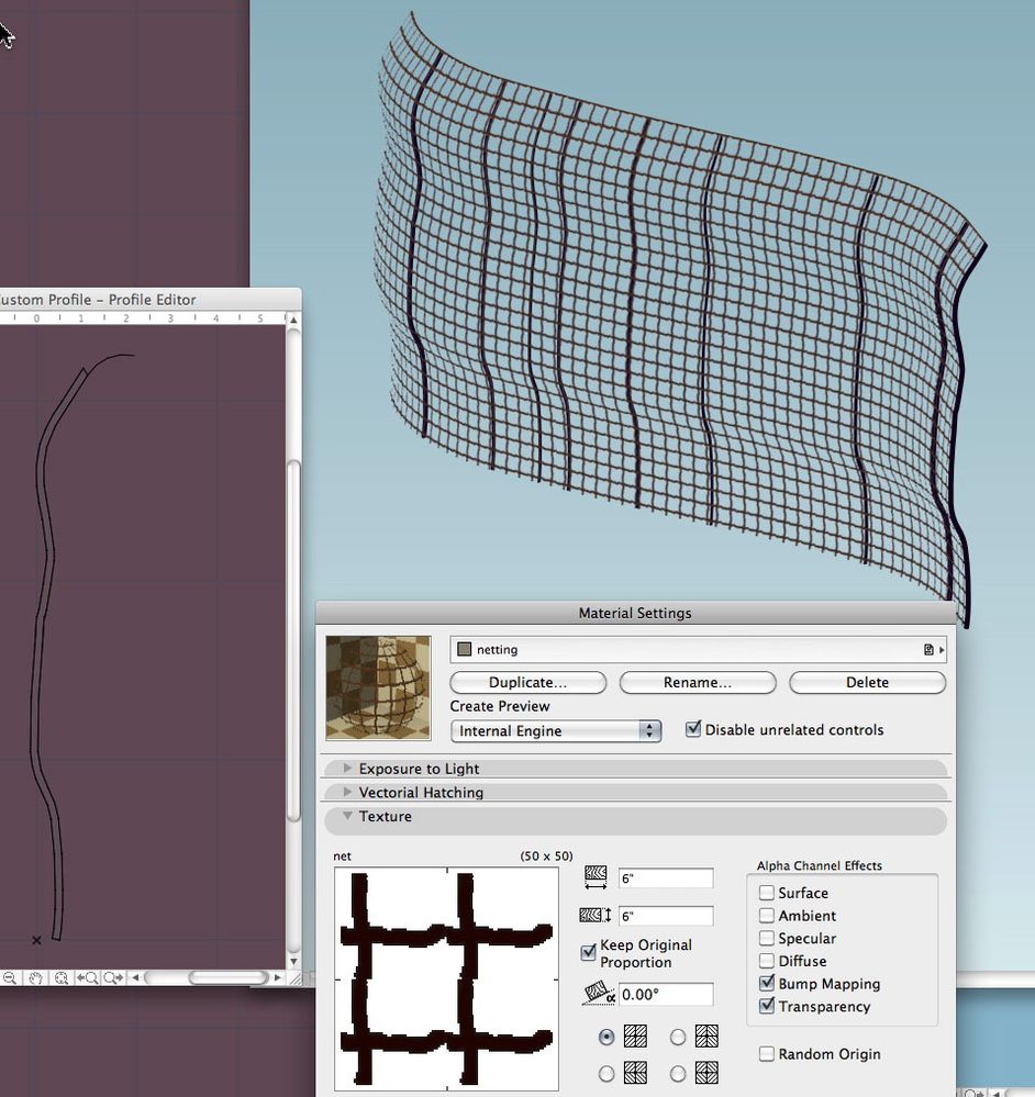

Dwight
For renderings:
Apply a net-like image as a material to a curvy-durvy wall.
Dwight Atkinson
Dwight
net texture
Dwight Atkinson
Hey guys thank you very much for your help! Can someone perhaps just give me the three most important steps in creating the wall. I know how to attach the texture but don't know how to create the wall structure at first. I know tried it with the wall tool polygonal I think... the prob is that the spaces between the web should be seethrough because there's a wood structure that you should see behind.
Karl Ottenstein
Moderator Emeritus
Dwight showed you how in his screenshot: a complex-profiled wall. He shows you the profile that he created for the wall in his illustration.
The spaces between are see-through via alpha channel.
Ok yeah I got it so far. I enabled transparency in the alpha channel setting but the spaces inbetween are still not translucent ..
Somebody correct me if I'm wrong, but I think alpha channel transparency is only available in rendered views, not OpenGL.
Edit: and I'm backed up HERE.
So I'm still stuck. I've got a the net structure to my wall but when I render it in OPENGL the whole wall disappears (probably because of the stettings in alpha filter)

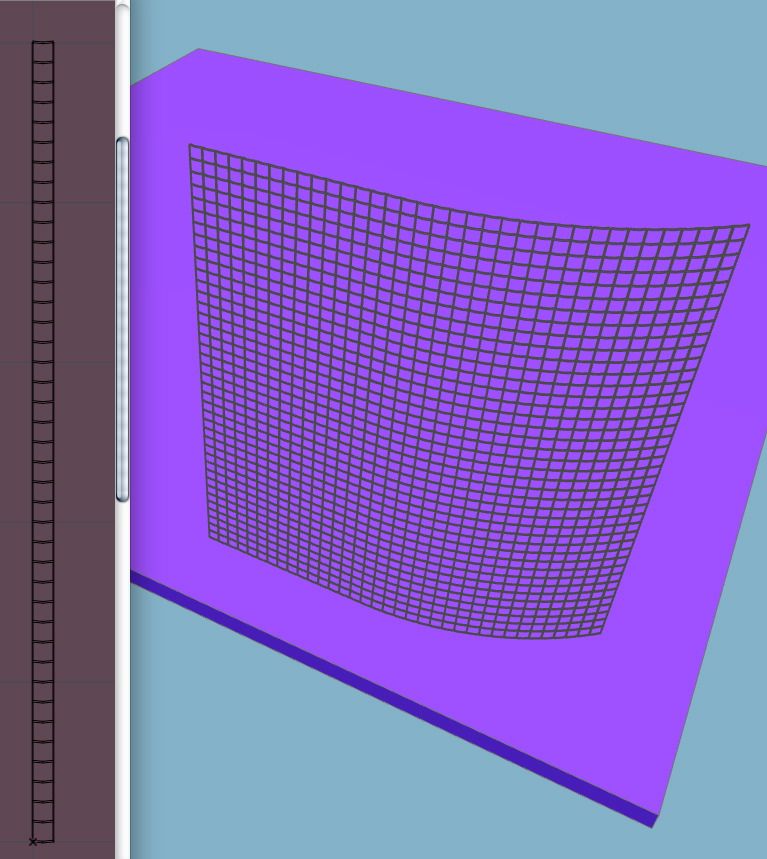

How to model netting:
1: With the complex profile tool, build a rope ladder to the right height.
2: draw one wall as a single rope ladder. [perpendicular to the net face]
3: multiply the individual ladders until they form the net.
