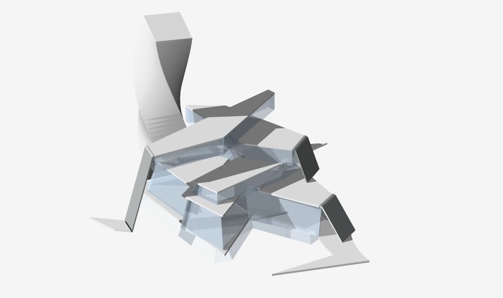

I am studying architecture ...and This is my second project i am doing in archicad !!!I feel that it could be rendered in a better way!!!
So may u guide me how!!!and What are the mistakes that i am doing!!

1: Add context. You are not a sculptor. Place the building on a ground plane with sky to pretend it is real.
2: Architecture should be viewed in perspective. You must emulate the viewer experience, not a parallel view abstraction.
2A: Use a viewpoint that engages the viewer to enter the building.
3: Sunlight is not white. Add some yellow to the sun.
4: Glass is clearer than that.
Post again once you have tried these ideas.

Thank u For ur reply.and please be patient with me because i am new to archicad!!
1.FOr adding the sky i added but it is not real at all!!!
2.I wonder how could i add the yellow light to the sun
3.how can i show the glass clearer
And i don`t want to zoom in so my mistakes will appear more!!

Everyone understands that the model is just hacked together. I think of it like pieces of cardboard cut out freehand, in the old days.
So don't worry about it.
A good composition is compelling regardless of the model completeness.
You should download the student version of Artlantis Studio to get better renderings. Artlantis has automatic sky.
Otherwise, use a photo background from the Archicad library.
To add light color to the sun, study the sun dialog accessed through the Perspective Setting dialog or the Camera dialog.
To make glass clearer, study the material settings for glass and find out.
