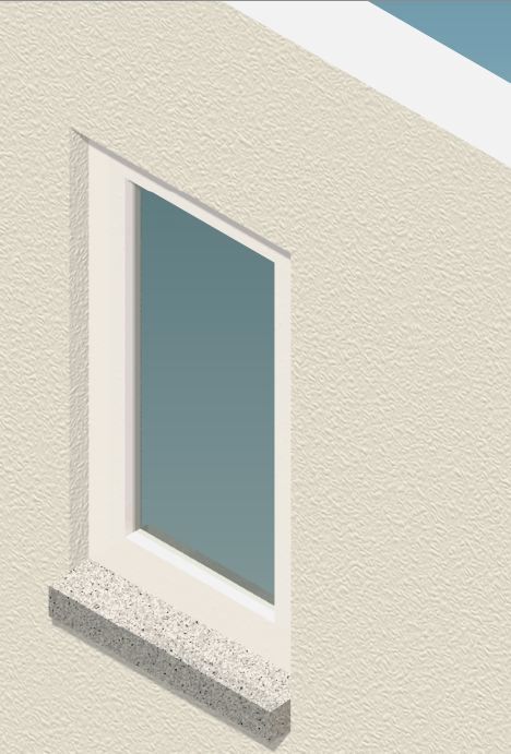

Any suggestions on eliminating overexposure? It seems SunObject settings which illuminate the vertical face always burn out the horizontal top of the wall.
The setup is SunObject (20%) + 2 x SkyObject (40% + 40%) + underSunObject (10%)
I reduce the SunObject power and use SkyObjects to compensate but the top keeps overexposing.

-- double check that you have the built-in sun turned off.
-- double check that there isn't a second sun object
-- add 0.01 roughness to the wall material
-- reduce the diffuse reflection parameter of wall material
-- don't use white.

Thanks for the reply:
....Internal sun is off
....Just the Undersun per your book.
....Roughness: Scale = .1 / Amplitude = .03
....Diffuse = .75
-- don't use white
....Stucco is a cream colour
Basically, my dilemma is that reducing Diffuse causes the vertical surface colour to render as a grey mess, whilst getting the vertical colour right leaves the horizontal surfaces burned out. Would it be advisable to boost Ambient light and reduce sunlight?

well....there's too much energy in the scene..... using mechanic's mind, eliminate the sky objects and introduce them one at a time...
