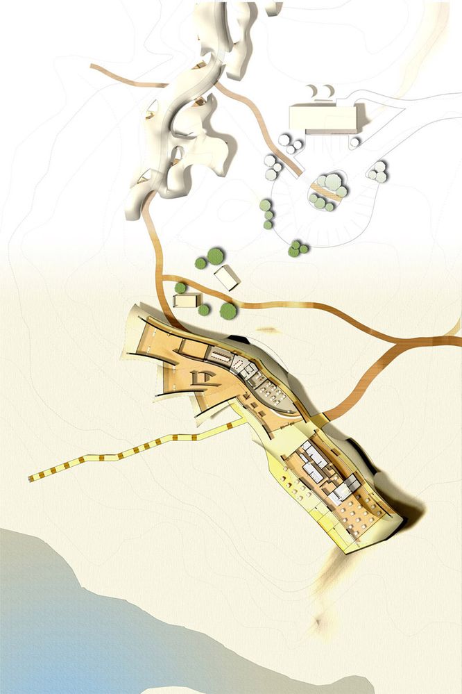

Please critique the lightworks rendering. In some cases there is a little photoshop touch-up.
There will be other renders following.
The first is a photo montage

Plan with overlayed Roof Plan

Dwight
The drama and beauty of this project overwhelm me.
The scene, the flowing beauty of the roofs. Ooo, baby.
There is hope for Archicad, yet.
Is this a real project? If so, the bile of envy rises in my throat. Where is it?
You've controlled the shadow depth with great realism.
Here's my critique of your panoramic montage, presenting two common issues found when merging renderings and photos:
1: the photo has film grain (or digital noise) while the model seems perfect and smooth. This makes the model look too good and it sticks out. (Not that, seeing this building in reality, it would go un-noticed) Add 3% gaussian monochromatic noise to your model image layer in Photoshop. If the light color matched better between rendering and photo, this would be less important, but the larger you get, the more obvious this smoothness difference becomes.
2: In a scene saturated with golden, late afternoon sun, i feel that the light falling on the building is too white. It looks too clean and cold. A quick gradient burn can fix this. It is hard to be sure because, unlike urban scenes, there's no reference white areas available in the photo.

Dwight,
Thank you, I am flattered.
Fantastic critique of the montage. Although this is the result of many montages, you have still managed to find a useful critique to better the image.
I am a big fan of your comments and I would like to purchase your book. I think you have a lot that you could teach me. How do I get my hands on one? and are you updating the book to contain AC10 information? If so, should I waite?
I only wish. This is a University project. It is based on a real project with a little tweaking and no budget of course. I would love to see the day Australia builds such a building. Hopefully in my life-time.
Where is it?
Anna Bay in the Port Stephens region of NSW, Australia. The site is at the Northern end of the largest mobile sand mass on the Eastern Coast of Australia. You can probably see the influence of the sand dunes in the design.

beatiful design! I find with spaces like your interior perspectives don't really convey how it would be perceived, your sectional perspective is a far better representation. if it was my project I would avoid showing narrow view interior perspectives and stick with sectional perspectives, they describe the space as opposed to merely taking a photograph from inside the space..
