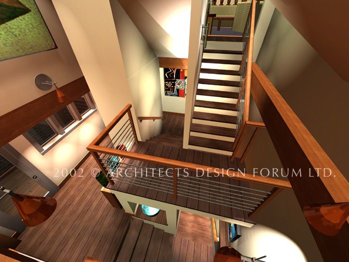

I do fair amount of interior renderings with lighting in artlantis ( I should say, I try to anyway). To be clear, I will set 20, 30, 70 lights in a model, some down lights, some general lighting to get as close to "photo realistic" as possible (see attached image) with in the limits of the software. Artlantis allows 128 lights.....how they picked this limit I don't understand, but I am not exceeding the limit, though I could if the program would let me.
It is frustrating to no end, when I have the lighting dialogue box open and try to re-arrange my list of lights, once I have place several lights in the plan in artlantis, the program will eventually CRASH. Usually only after I have been doing two hours of work and have not saved changes.
If I am "tweaking" light settings while switching between individual lights before the preview window completely refreshes, the program will CRASH!!!!!!
It has gotten to the point where I have to save my file virtually every two "tweaks" of lighting or I am in danger of losing data. Problem with this is it takes a long time to save the file if there are alot of lights or polygons.
The program is fine with a couple of lights, but if you try to get into realistic lighting with many lights, the progam just craps out. I have written to Abvent, but they just ignore the problem......big surprise there.
By the way this problem has occured since v3.5 of arlantis.
I use a G4 933 with 1.5 gigs of RAM and a 120 gig hardrive. Its not the machines problem, it IS the software, it is very unstable when it comes to minipulating many light sources.

I am sorry for this very late reply, but I have one question and one request :
- Who did you sent your question to at Abvent ?
- Would you please send me a sample file that crashes above a certain number of lamps?
Best regards
rm
Best regards
Jacques, I sent two seperate reports and files through the "Incident Report In North America" on your web site. I have no record of it because it is Abvents form.
I will send you a copy if you give me your direct email address.
Trust me, I can crash the program almost at will once I start manipulating lighting for interior scenes. As previously noted, this is not a problem with one or two light sources, or shaders for that matter.
The file that created the rendering I have attached to this thread must have crashed the program 30-40 times. It does have the maximum 128 light sources. However the current project I am working on only has about 30 lights, and it crashes too.
