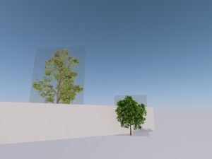

Transparent plane is visible on render of tree
Affected version: 18 and newer | Severity: workaround applicable | ID: 174176
Issue
The plane of the new tree object is visible with standard engine where there is no modeled background.
Cause
This side effect is caused when the RS->Effects->Color Mapping->Exponential is ON or when the value of the Color Mapping -> Dark Multiplier, Bright Multiplier differs from 1.
Workaround
  • as a workaround use physical renderer
  • or use 3D trees with the standard engine

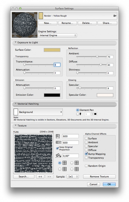

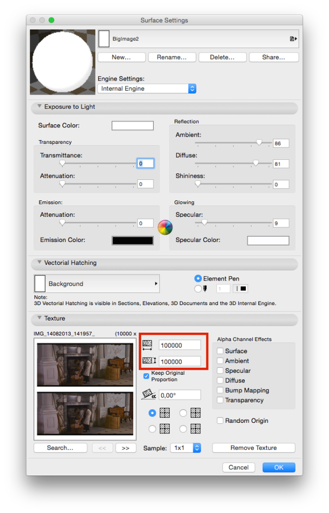

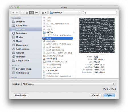

Applying huge textures to Surfaces causes slowdown (beach ball) on Mac
Affected version: 18 and newer | Severity: no workaround applicable | ID: 211370
Issue
Adding a big texture file to a Surface (in case of Internal Engine and OpenGL Engine) causes Mac to load it for a while (spinning beach ball) depending on the size of the image.
Workaround Reduce the size of the original texture image in order to eliminate the speed problem.

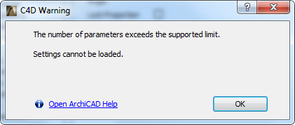

Warning message: Unsupported parameter was found in C4D material. Settings cannot be loaded
Issue
Importing a surface created in Cinema 4D with “Load C4D Settings” causes a warning dialogue, if the software uses unsupported shader. In this case ARCHICAD doesn’t import anything.
Unsupported C4D special shaders:
  • Sketch Material
  • Color stripes
  • Star
  • Proximal
  • Spline
  • Ripple
  • Dirt
  • Vertexmap
  • Terrain Mask
  • Object Color
Unsupported C4D volumetric shaders:
  • Fog
  • Terrain
  • Cheen
  • Nukei
  • Banzi
  • Banji
  • Danel
  • Mabel
Workaround
Remove the unsupported shaders from the surface in Cinema 4D and import the file again.

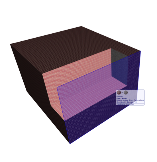

Surface Painter on Solid Element Operation surfaces
Issue
Painting surfaces which were created with Solid Element Operation is not possible
Solution
Workaround: The Operator element’s surfaces have to be painted so the Target’s surfaces inherit the surface overrides.

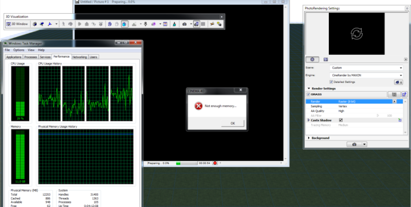

C4DRendererPlugin: "Not enough memory" CineRender warning
Affected version: 18 | Severity: workaround applicable | ID: 176023
Issue
Memory and speed problems using CineRender rendering engine
Solution
Please see the points below to avoid memory and speed problems using CineRender rendering engine
  • Available memory and number of cores
    • If your computer does not have enough physical memory, then renderings will be slower, as your computer will need to use virtual memory. Have at least 8GB or more on a 64-bit operating system. Read more about 64-bit
    • ARCHICAD and CineRender both utilize the benefits of multi-core processors. Since CineRender engine uses CPU power to generate renderings, having more cores in a computer mean less time to finish. 4 and 8-core processors probably represent the best price/performance ratio.

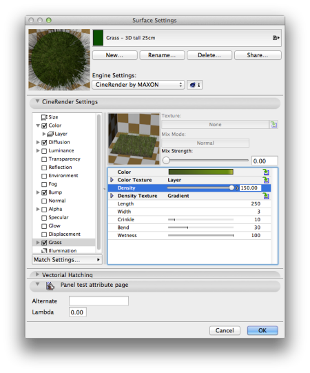

  • 3D Grass
    • 3D grass is not visible in 3D, it is generated during rendering in the memory of your computer. If you are rendering large areas covered by 3D grass surface, and experience extreme slowness or run into the warning 'Not enough memory to render the image', then you should consider:
    • - reducing Grass Density in the surface settings
    • use a Gradient Density texture, which produces 3D grass to smoothly fade into a grass texture
    • reducing the size of the 3D grass areas and use texture grass surface on areas that are further away from the camera
    • turning off ' Casts Shadow' in Rendering settings/Detailed settings/Options/Grass
    • turning off 'Grass' in Rendering settings/Detailed settings/Options/Grass
    • extending the physical memory in your computer (16GB is usually enough)
    • using SSD to prevent your rendering from being irresponsive because of lacking memory during swapping.
  • Rendering quality
    • Rendering quality is based on the Global Illumination- and the Anti-aliasing settings.
    • Try to change the Rendering quality, use a lower quality preset such as “Low” or “Medium” in the rendering settings.
    • When using built-in rendering scenes, try to choose a scene of Fast or Medium quality.
  • Shadow quality
    • The quality of area shadows (similarly to other blurred effects as blurry reflections for example) has a great impact on rendering time.
    • Try to change the Shadow quality, use a lower quality preset such as “Low” or “Medium” in the rendering settings.
  • Number of light sources
    • More light sources mean more memory usage and longer rendering times. Turn off lights (it’s possible to do so in the light settings as well as in the infobox) that you do not necessarily need for a given scene. (like internal lights on a sunny picture, which are not even visible).
  • Use the marquee tool
    • The 2D Marquee is useful for limiting the model to a ‘box’ that you need to show in your rendering. This reduces the polygon count of the model. Also turn off layers that you do not need.
  • Custom Textures
    • Make sure that textures (bitmap or JPG images assigned to a surface, or HDR images applied onto the Sky Environment) are sufficiently small (in the few kilobytes region). You should never use images hundreds of kilobytes large as materials. Watch out for .gsm objects imported from third party applications like 3D studio or SketchUp.
  • Caustics
    • Surface and volume caustics are using millions of photons, thus need enormous calculation time. Try to reduce the number of photons in Light settings/Effects/Caustics, or simply turn off Surface- and/or Volume Caustics in Rendering settings/Detailed settings/Effects.
  • Other options
    • Make sure to check the Rendering settings/Detailed view/Options/General options list and uncheck all features that you don't need (e.g.: Blurriness, Visible light, Sub-Polygon Displacement, Sub-surface scattering), and try to increase the Ray Threshold value up to a minimum of 10-20%.

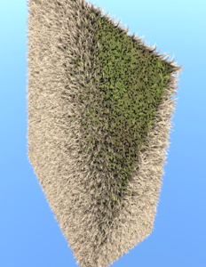

Blades of the Grass will become sparse when zoomed close and rendered with standard engine
Issue:
When rendering an object with grass material and with standard engine with the grass effect turned on in the render settings, the closer you zoomed on the object, the sparser the grass blades will be on the rendered image.
Cause:
Rendering engine related issue
Solution/Workaround:
It will be fixed with the update of the render engine, which is expected in version 19.

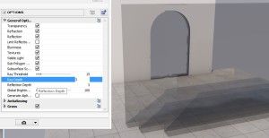

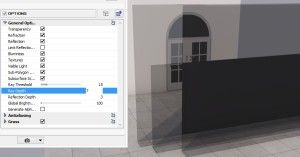

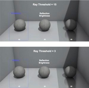

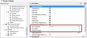

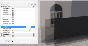

CineRender and glass surfaces
Issue In some cases you might notice that the glass is not transparent in the Render.
Cause

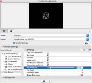

As soon as you change the default render setting, the scene will turn to Custom. We receive more and more reports about transparent issues with Glass surfaces. There are two important parameters: Ray Depth and Ray Threshold . It is suggested to read the C4D help while changing these values. In the following example I will show the most common settings for the Glass Surfaces transparency in case there are more than one layer of glass surface is needed.
Solution
If you go to CineRender detailed option and you open the Options part, the default setting for a General Outdoor Daylight are the following:
Please note: in the example case on the image below you can see 3 glass walls and a window in the background. Every glass wall requires 2 depth values (one for the inner and one for the outer surface of a glass wall). If you would like to see trough 3 Windows, the minimum value is required to be set to 7 (3x2+1) but if you wish to see through the window as well, it is suggested to set to 9 (4x2+1). It is important to know, as higher as this value is, as longer the render time will be. default:
change 1:
change 2:
change 4:
In the image above the changed parameter value helps to optimize render time. With complex scenes, particularly those containing many reflective and transparent surfaces, 90% of the processed rays contribute less than 10% to the general picture brightness and color. With a threshold value of, for instance, 15%, the rays stop their movement from the camera into the scene as soon as their brightness falls below this value. Please note: as soon as you change the Ray Threshold value, your render time will require more time to succeed.

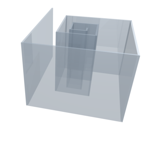

Transparency in 3D window
Issue
Multiple transparent surfaces are displayed randomly when overlapping each other.
Cause
Determining the color of a pixel on the screen is a complex process when there are several transparent materials overlaid. All the visible materials at that given point have to be considered - the color, the transparency, and the display order matters. This calculation can be very time consuming, so the OpenGL engine simplifies the process to ensure that 3D navigation remains reasonably fast. ARCHICAD determines the outermost surface but does not calculate the order of the materials behind it. This results in a much faster calculation, and gives the correct result with one layer of transparency. However when there are several transparent materials covering each other, the result is not correct.
Solution
The OpenGL 3D mode is for fast, navigable representation of the model. For a perfect representation of colors and lighting effects, use the built-in rendering engine. Rendered images will display transparency correctly.

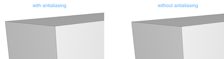

Antialiasing is not Available on Computers with Certain Video Cards
Issue
The 3D view does not seem to use antialiasing. Warning message appears in the Work Environment settings window at Advanced Redraw Options: "Warning: Antialiased drawing has been automatically disabled due to insufficient video card resources."
wp-content_uploads_archicadwiki_bugs-antialiasingnotavailablewithcertainvideocards--antialiasingwarning.png
The problem occurs on MACs with mainly AMD video cards but some configuration with NVIDIA or Intel card are affected as well.
wp-content_uploads_archicadwiki_bugs-antialiasingnotavailablewithcertainvideocards--antialiasing01.png
Cause
Antialiasing is turned off by ARCHICAD for the following video cards because some functions in the video card drivers contain bugs. These bugs cause that some of ARCHICAD's new features do not work properly when antialiasing is active or can result in crashes. The affected video card range depends on the version of the Operating System and ARCHICAD. ARCHICAD 16 Hotfix 3 (build 3487)OS X 10.6

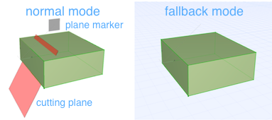

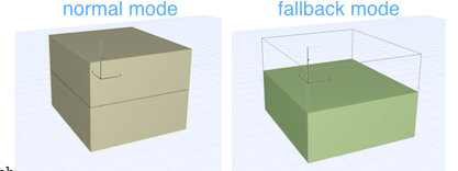

Solution
If your video card is in the list above, but you need to have antialiased 3D display, you can turn it back on with a plist tweak (detailed below) at the cost of loosing many of the 3D window's feedback guides:
  • The automatically resizing Editing Plane ("the blue grid")
  • Real-time feedback during repositioning the Editing Plane
  • Plane selector around the cursor ("the gray rectangle")
  • Cutting plane display ("the red plane")
  • shaded feedback will be exchanged with wireframe while editing a Morph
  • texture positioning feedback on a Morph face
  • protractor feedback for 3D rotate

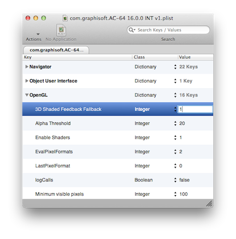

How to turn on Antialiasing
  • You will need a Pref Setter application to edit the plist. (available here)
  • Launch Pref Setter
  • Open 'com.graphisoft.AC-64 16.0.0 INT v1.plist' from User Preferences
  • In OpenGL dictionary set the value of '3D Shaded Feedback Fallback' to 1
  • Save the plist and restart ArchICAD 16.

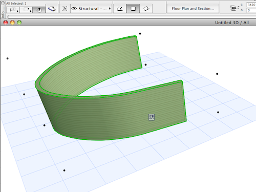

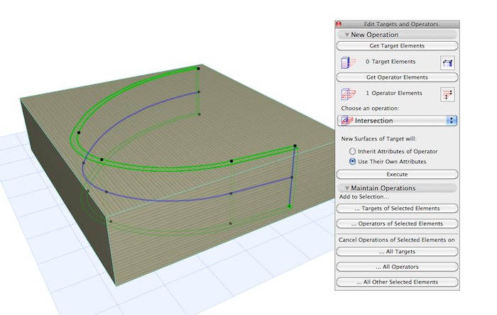

Texture directions on Shell
Issue
In the following article I will try to explain how the materials/textures are presented on the Shell. The image below shows an Extruded Shell with a striped texture .
As you can see the Shell on the left side has different textures on the Shell.
Cause
The reason of this that the Shell has box texture projection and the direction of the texture changes where the projection box has its edges.
NOTE: slab has the same issue
Solution1
There is a workaround to correct the textures but with the workaround Shell will become a Slab
  • place a Slab with the same texture around the Shell
  • use Solid Element Operation and set shell as Operator and Slab as Target - use Intersection
  • hide the layer of the Shell
Solution2
Create a Morph from the Shell and Align Texture using Sub-Element Selection of Surfaces.

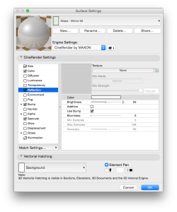

Issue Reflection is not considered if the Reflectance Brightness (Options/Element Attributes/Surfaces/CineRender Settings/Reflection/Brightness) value is below a specified number.
Cause The value of the Ray Threshold has an impact on the Reflection. With complex scenes, particularly those containing many reflective and transparent surfaces, 90% of the processed rays contribute less than 10% to the general picture brightness and color. With a threshold value of, for instance, 15%, the rays stop their movement from the camera into the scene as soon as their brightness falls below this value.
Solution Decrease the Ray Threshold in the PhotoRendering Settings.
