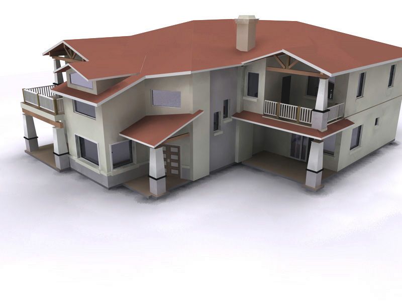

I was just testing a HDRI model setup with C4D, I added an archicad model into the scene and produced a 90 frame animation. BTW it took about 1.5 hrs. - approx. 1 frame per min.
Anyway, can someone tell me which setting I need to change to eliminate the rounded areas on the final few frames. This is just a test in order to learn the HDRI light settings. Thanks

HDRI lighting is something else, eventually I will learn how to control it and utilize it for placing a rendering into an existing scene (photo). That is where it gains it best use. Using the Uffizi_probe I generated the above image. Please excuse the repeated use of this ArchiCAD model, I am too lazy to export any others.

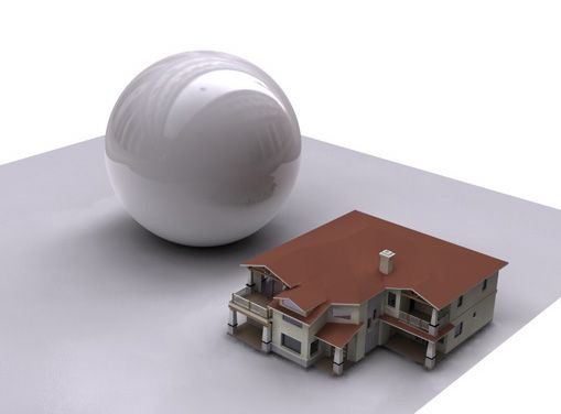

Another test using the same probe,... that somehow sounds clinical.
Mark,
I'm not sure what -all- your settings are, but the basic look of your render doesn't _seem_ to differ from what we can get (quickly - 5 mins or so) with just 'soft shadows' turned on.
Do you want to do a side-by-side comparison?
... but HDRI is *great* for incorporating a sky / photographic entourage.
- Stuart

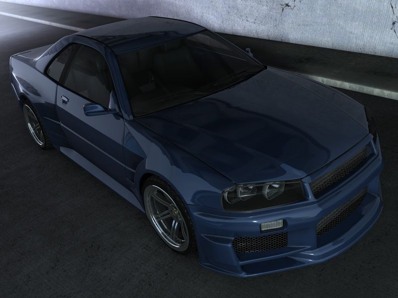

O.K., I'll go back to real work now, but just one more post. A rendering of a sample file by Mike Batchelor. This one is done with radiosity, 100% strength, 100% accuracy, 1/2 pre pass size, Diffuse depth 2, samples 90, min resoluton 30, max 50.
2:57 min on G5 Dual Mac 2GHz. Radiosity takes a long time? Think nothing of it.
On your mark, get set, go. 1 min. 54 sec. DONE - Nice street material and car for a driveway scene. This file is a sample also supplied free with C4D.
Why do I keep posting this stuff? Well if your goal is to create a realistic and artistic scene in and around your building model, this stuff is pre-made to drag&drop. Other rendering programs should also provide such useful additions to their software offerings. I haven't even begun to explore the slew of architectural textures supplied with the ArchiCAD Translator.
