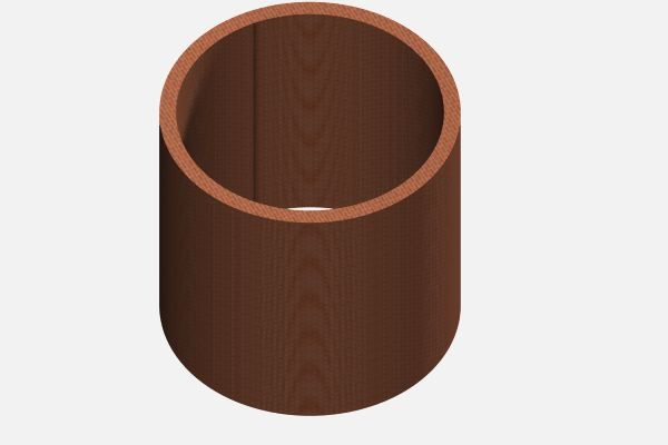

Separation of rounded wall for AC10
The separationline for rounded wall must be avoided.
How can I avoid this line for 3D Window and Rendering?
10 Replies 10
The rendering picture for that

I don't get this on a plain surface.
What texture?
What wall size and diameter?

This is about 8m high, and 4 diameter, surface red brickwall

Glitch Confirmation Desk calling:
• the foreground cylinder duplicates your problem.
• the background cylinder attempts to obscure the problem by duplicating the walls and rotating them 90 degrees.
Nothing gets hidden - this just adds to the number of seams showing.
Possible solution:
Use a tube instead- it seems to have smooth mapping.
