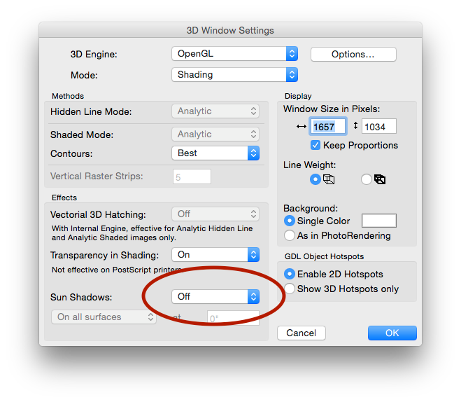

Hi I'm a new user to Archicad and im have an issue with getting shadows to show when i put my model into perspective view in the openGL engine.
I'm pretty sure the sun is actually showing as when I change the settings I can see a change in the ambiance of the model. Where can I find the settings to make all my elements cast a shadow?.
8 REPLIES 8
Eduardo Rolon
Right Click on empty space in the 3D window and select "3D Window Settings"

Ive already checked that setting and its still has no effect. I did wonder if it had something to do with the individual elements and if there is a setting to allow them to cast shadows?
Shadows for objects can be controlled in the scripts but for other elements there is no individual control - they all have shadows.

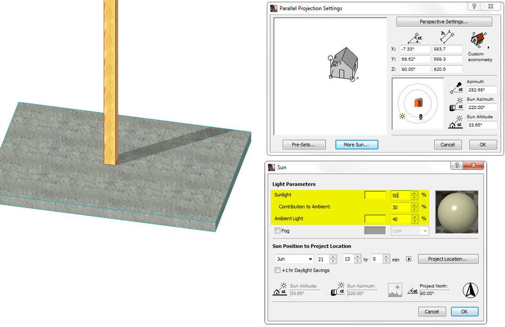

What is the percentage of sun in your 3D projection settings?
If it is set to 0% then there will be no shadows but if you still have a decent percentage for ambient light you will still see your model as being lit.
Ive been playing around with the 3d projection settings and still no shadow when the model is in perspective. Would it be possible for you to send me a screen shot or your settings so i can replicate that to see if that will fix the issue?
Does this help?
3D window is viewing with OpenGL with shadows "On".
Hi Thanks for this i have figured out what the issue is. The settings where right but my graphics card isn't up to scratch which is why i can see shadows with the internal engine and not openGL.
