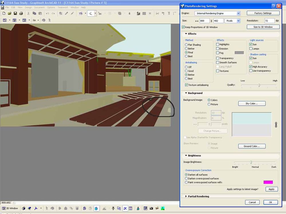

I was having the same issues, so thank you Karl for resolving that. I do have another question though about the shadows in the sun study.
I have the settings posted in the jpg and was wondering how I can get the shadows to really contrast within the image. Very dark in the shade.
#2 is the fact of the rendered source view. Within the parameters of the sun study it gives you two options,
3d window and photo rendering window. Are these two technically the same?
I know that the adjustments are made in the photo rendering settings but I cannot seem to figure out the difference. Which one is better to make this as quick as possible?

If you get the sun study from the 3D OpenGL windo, there's no shadows. If you get the sun study from the 3D Internal engine, it looks like drafting with tones. For darker shadows here, go into the sun dialog and reduce ambient light. Give it also, a dark color.
If you want more contrast in your LightWorks rendered shadows, eliminate skylight and ambient light.
Dwight Atkinson
Dwight -
Thank you very much, it worked well!
