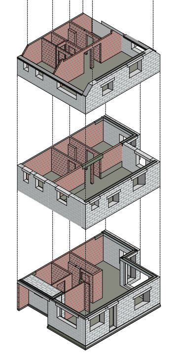

1. a vectorial hatch to scale for 3D documents - isometric views - see e.g. the brickwork in the attachment

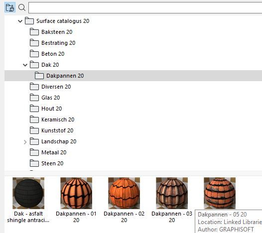

I just looked a bit deeper in the additional surface library.
Another reason I was hesitant to go that route was the lack of bump maps.
For roof tiles, the texture image itself is used as the bump map, which is not how it should be done..
But I also found some bricks with proper bump maps now. So the treatment and quality of the materials is not very coherent.
Screenshots attached - is that a local library?

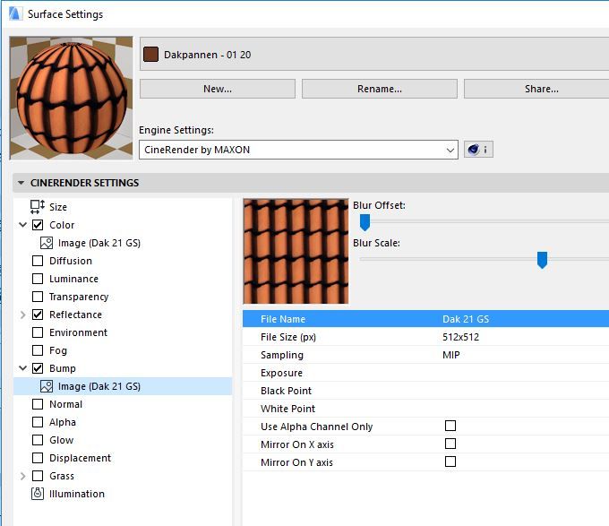

and the bump for the roof tiles
