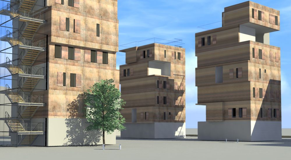

This is my first Archicad model and Artlantis rendering job. But I get a problem with the texture. I have been using one of my own textures, But when I apply it to the external walls of my Archicad model it works fine on 2 out of 4 sides of the building, on the two other sides its just a stretch, looks like the texture doesnt "bend" around the edge of my model.
Any way to solve this issue?

You need to choose orthogonal in the texture mapping dialog. It is the button on the botom of the dialog. When you do that the texture will be 'wrapped' around your object in stead of stretched.
I hope this helps you
Sjaak

Thanks Sjaak, this does indeed help. The texture is good, Its supposed to represent panels in some way, but i see what you mean, will look into it
