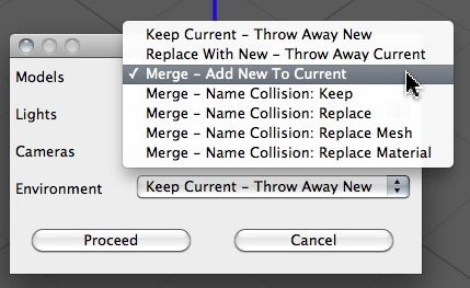

Import is manageable. - delete the old and then add the new....
I would manage this with layers, building the scene with imported 3Ds entourage and isolating actual Archicad design elements for simplified deletion.

Hi Andy,
since there's no plugin for ArchiCAD at the moment, the worflow between Thea and AC is different form the one between Artlantis and AC.
That said, replacing a model in Thea is not as painful as it seems. Material assignment is a breeze, and having layers to store your various models is quite efficient too.
Then in regard of adding props to your models, the instancing tool is very valuable. And high poly count isn't a problem, I've rendered scenes with over 100mil polys.
Now in terms of rendering, Thea sports 2 different rendering engines, one unbiased (think Maxwell), the longer you render, the better the result. The second engine is biased and allows for endless tweaking and optimisation depending on the type of scene to render. Both engines allow you to create and save presets for later use.
As for batch rendering, it's possible now via some sort of scripting, but I'm fairly confident it will find it's way to the UI in the very near future.
But given you get two render nodes when buying a license, nothing prevents you to have dedicated rendering machines on your network.
Finally, looking at Thea's roadmap, you'll find out that GPU rendering is not far off 😉
Hope this somehow answers your questions.

Hi Dwight,
I'm still to check whether replacing the old model with the new one will automatically assign the matching material.
For the time being I only export the amended parts of the model when possible, and manually delete the superseded ones.
