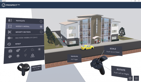

Hi all and happy new year!
I just thought I'd share our story about our journey with ARCHICAD and Virtual Reality for all that are interested:
https://bim6x.com/blog/venturing-vr-archicad
Cheers,
Link.
