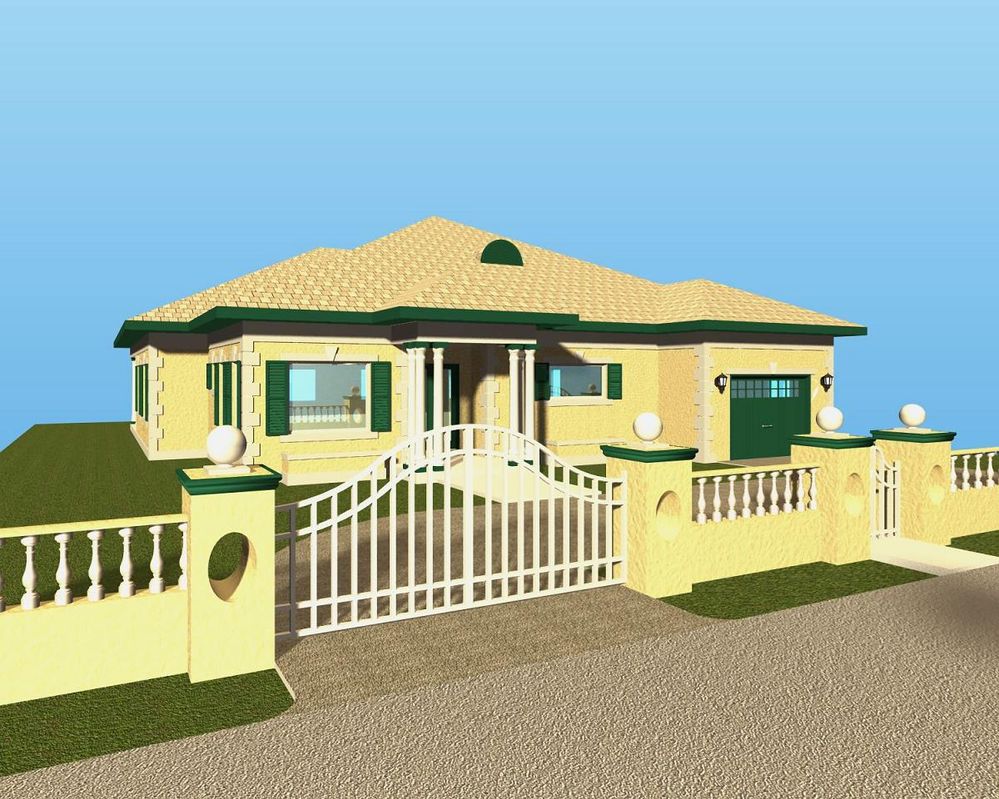

I need some help on this exterior i'm currently workin on. How can I add some more detail to the scene (trees, plants, car).
I am attaching my rendering settings as well be cause i feel my render is too saturated with color. I also attached a pic wit some photoshop post work.

Photoshop Glow added
Settings
Undersun
Intensity=55
shadows= off
General Light
Intensity=50
falloff=1.00
Realistic Sun
Num. Samples=60

You have too much sun and ambient light. Cut them in half to start. Why using general light?
Entourage is added with library parts. There are cars and people and trees available in the basic library.
Stretch the model base to eliminate the "lost in space" feeling.
ALL renderings have too much color.
