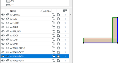

I cannot get walls to clean up after importing model from v26 template. Layer intersections are set to 1 or 0. On-screen view options are set to intersection. Legacy option is not turned on. See below. What could be causing this?

A layer intersection group number of zero (0) will mean the walls will not intersect.
I see you have set all of the layers to '1'.
With 'Clean Wall & Beam Intersections' on, that should be all you need to do.
However if you are using a layer combination in plan (rather than 'Custom' - which you really should not rely on), then you need to check the intersection number of the layer in the combination is not '0'.
Changing just the layer intersection number does not change it in any of the layer combinations, you have to change it in the combinations for them to work properly.

I set all layers to 1 including the combinations and they still will not clean up. I saved the file to v26 and they clean-up without changing anything.

If you are sure the layer numbers are correct then that should be fine.
The legacy option should have no impact on the walls actually trimming (just the way they trim).
Clean wall & beam intersections is the only other thing I can think of that affects this - but you have that on.
Your wall reference lines are touching at the corner?
It looks like they are but it only takes the smallest of gaps to break the connection.
But if you say you saved this back to 26 and it was fine, I can't see that being the issue.

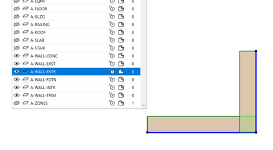

Check the renovation states and their options.

2023-10-19 08:31 PM
The renovation status was set to cleanup walls. However, the walls will not cleanup until you first select an option from the pull-down. This appears to be a glitch.

2023-10-20 03:34 AM
The problem occurred while converting my v26 template, with walls that were already placed in the model. As soon as I selected a reno option (any of them) then the walls would clean up and stayed clean. Very odd.

2023-10-20 11:59 AM
Thank you for this! I had the same problem, I was editing the graphic override rules for our template (also from 26) and suddenly the walls wouldn't join. Changing renovation filter to another and then back fixed it.
I also noticed that the Clean Wall & Beam Intersection and the Wall & Beam Reference Line options seemed to work as linked toggles during the "buggy mode". Selecting one would activate the other (though not fix the visual intersections, even though the option was turned on), even though they should be independent of each other?
