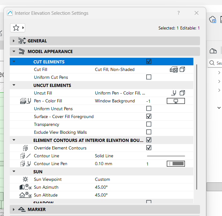

Could you please share a screenshot of the model Appearance of the Section Selection Settings?

Hi Ricardo,
here is a snippet of the interior elevation selection settings for it:
It is a splashback wall overlayed in front of the internal wall.
Hope that info helps.

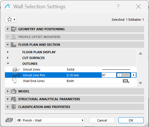

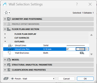

Hi @clauds1223
What about the Wall Settings for Floor Plan and Section? Is the Outline Uncut line pen a visible color (black/grey)?
Using a white pen for that is the only way I've been able to reproduce your problem.
