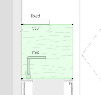

I have a wall with a surface attached to it and i want to show this surface hatch which I have managed to to but for some reason the outlines of the wall isn't showing. Please tell me how to fix this.
This is what it looks like and i would like it to have a solid grey outline to stand out.
Friday
This is a Section/Elevation?
I assume you are missing the left and top outline of the wooden wall panel thingy?
Can you also show a 3D of this detail so we can see how that Wall piece is situated in relation to everything else?

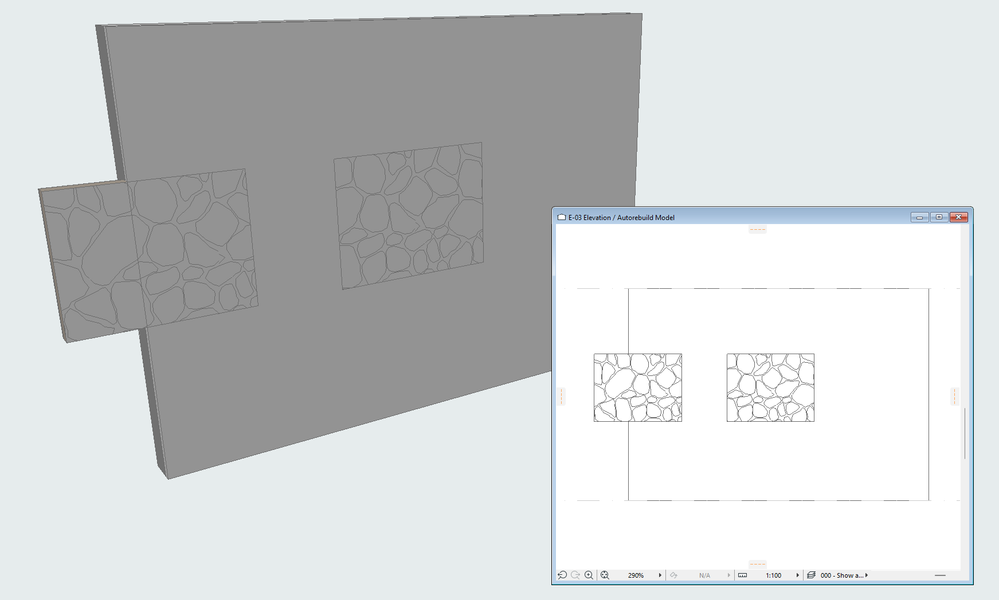

I am looking to see the contour outline of a wall in archicad.
This is the wall as shown in the interior elevation - it shows the surface fill but why is it not showing a dark outline to highlight the extents of the wall?
5 hours ago
You have already posted this and Laszlo asked if you can show it in 3D.
Overlapping walls should show their contours.
It is hard to say what you have done without having the actual file.
Here I have just duplicated the surface and added a surface hatch.
Then added a wall with the duplicated surface.
