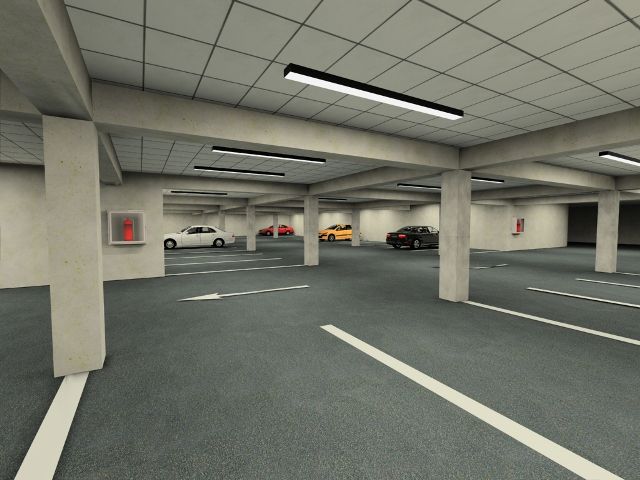

Hi, when i see your mesage i took my archicad, model this garage, export it in the lightscape and this is what i get in 30 minutes.

I will stick with lightscape, and only program that i will use. I think that in the future artlantis will be best solution for us, architects.
Fast - good - results.
