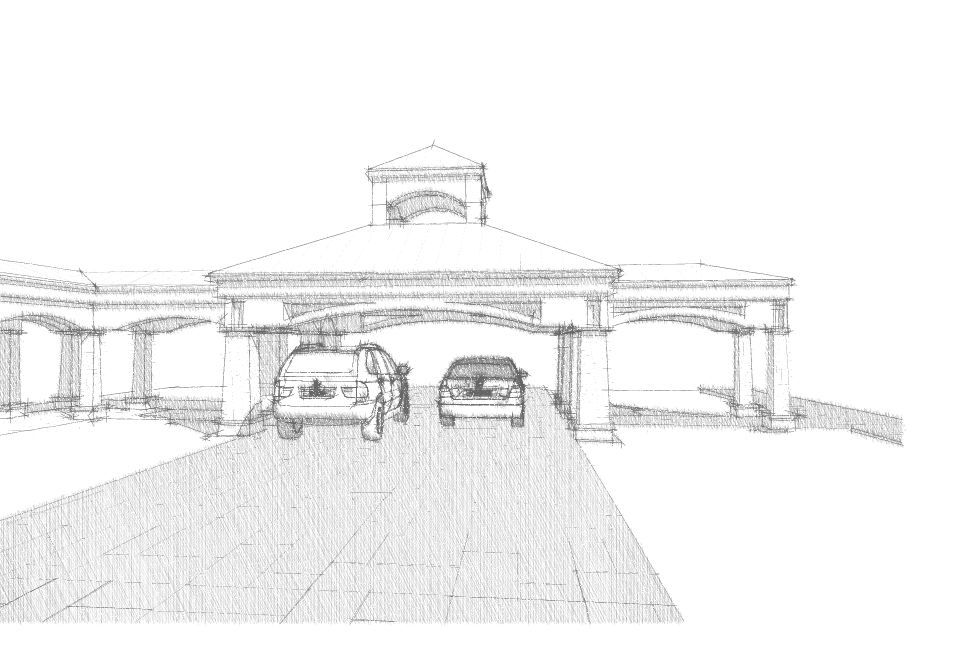

ok so this is what i have so far, now keep in mind i really only had one day to do this project from start to finish. i.e. design, build model, and render final image. I could not get a water color look that i like using light works and photoshop so i did a combination of light works, sketch render and photoshop. Let me know what you guys think.

yeah like i mentioned before very simple
take your light works rendering ( make sure its a saved view so its the same as the next step) and bring it to photoshop
then use the sketch render with the pen and ink setting how every you like it.
take both of these images into photoshop and make sure the sketch image its on the bottom layer so every thing looks more artistic and faded. then add the light works image on top of that set to about 50% opacity, then fill in your back round with the actual site images also set to 50% so it all matches

That rendering looks great. I had a client want the same style for their project. I rendered it in Artlantis and did a sketch rendering in AC. I did as you, in that I layered the images. I put the colored image on bottom and the sketched image on top. I ran the water color filter in PS on the colored image
then used the texture filter on the colored image to make it look like it was on canvas. I then used the eraser @ 50% trans to erase the sketch rendering
till I got the effect I wanted.
