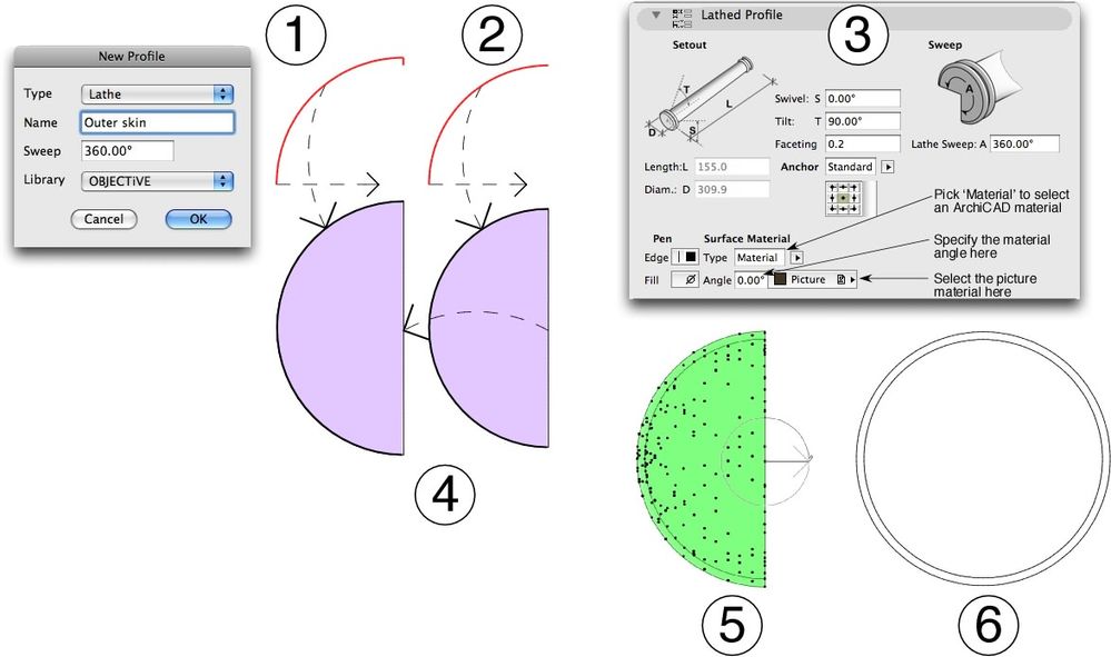

You could try OBJECTiVE. It includes profiling tools that can easily create the lamp shape. I created the attached image by lathing (sweeping) two profiles (one for the outer skin and another for the inner). Objects created by this add-on have a parameter to control the material direction, so an image can be aligned correctly.

now im trying using Ralph's Objective, is exactly what i want, but i don't know how it works... Ralph can u give me more tips how you do that?
Thanks
Ralph Wessel
Mentor
Refer to the attached image:
  • 1. Create a profile for the outer shell of the lamp fixture. Do this by drawing the profile with the poly-line tool (I've drawn a curve and a short straight segment. To create the profile, select the poly-line and use the menu OBJECTiVE -> Component -> New Profile. The New Profile dialog will appear - use the settings shown in the attached image (you may want to pick a library of your own though). You will be prompted to draw the centre-line of the lathed shape - do this as the dashed line indicates. A new profiled object will be placed overlaying the shape you drew.
    2. Repeat step 1 for the inner shell of the lamp fixture. I've drawn a single arc with the poly-line tool in this case.
    3. Create a material for the inner shell as Erika indicated, and select it in the settings of the inner shell object (as shown in the attached image). The outer shell can be whatever material you like.
    4. Drag the inner shell into the outer shell
    5. Rotate the two shells into the correct orientation by selecting them both and using the menu OBJECTiVE -> Tools -> Rotate
    6. The finished lamp should look something like this in plan
I can send these completed objects to you if you're pressed for time - let me know if this will help.

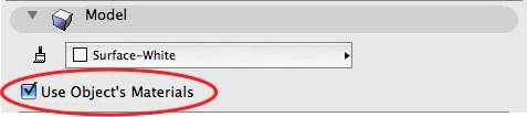

i did all steps as u said, but when i select the material (any material) for inner or outer shape and press ok, the shape don't change still dark.
Make sure the option to 'Use Object's Materials' is checked (see attached image). Also, you may want to put a lamp inside it if you want the fitting to appear lit.
