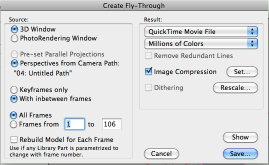

how do i play my fly through?
This is the first time i've ever created a fly through so i'm a little stuck. I positioned all my cameras where i want them but now i dont know what to do in order to play it. I want to be able to play in quicktime so i know i'm supposed to save it somehow but i'm ot sure how.
Any help?
1 Reply 1
Stress Co_
Document> Creative Imaging> "Create Fly-Through"
Should give you the attached popup window. Select save and it will prompt you for a location to save to.
Open the .mov file with Quciktime
