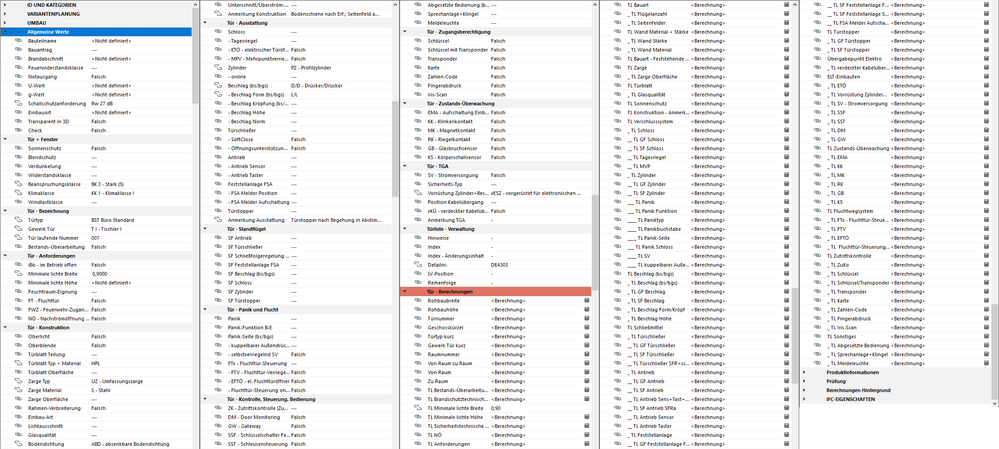

This is (a shopped-together) screenshot of all our door properties.
This reflects ~30 years of our offices work with door schedules on projects with thousands of doors, some of them on the scientific side like:
"Oh - you got a laser in your lab? Then we need extra nonreflective surfaces on frame & leaf & handle!"
"Huh - bio-hazard you say? This one shoud better be air tight..."
From blue to red is the input part for the user/planner/designer,
from red to end are calculations which end up in schedule or labels.
So it's about 50/50 visible/hidden when it comes to door editing.
Due to other - eh - AC shortcomings, some user input and almost all calculations are hierarchical.
The option sets for user input mostly contain "abbr. - explainig comment" like "ODC - Overhead door closer".
In schedule and label you'll only see "ODC".
This ODC can be installed on either side of the door and on both leafs or only the main leaf, it might have a mechanism to keep the door open, which in case of fire has to be released... Zillions of combinations which can't be presented in one single option set but have to be clicked together in bits and pieces.
