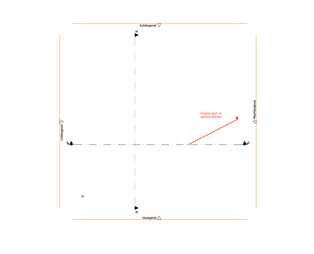

I would like it to be possible to add an angled part of the section marker (on floor plan) and not just a parallel division what is now the case.

That will only work for elements exactly on the section line itself - a zero depth section.
Elements in the distance will all tart overlapping.
rakurs
A decent workaround is to have multiple sections, with varying displaying of markers (start - only left, end - only right, middle sections - none) and a common name, and to stitch them on a layout.
You could use the interior elevation tool in polyline mode...
lorianerfreire
It would be great if section lines could support angular jogs, not just jogs parallel to the original direction.
This would help avoid having to create two separate sections and manually compose them in the layout.
