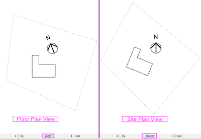

It would be beneficial to have an object that automatically reads the floor plan's north orientation from the model and can then be placed on either a layout sheet or a master layout.
If the north arrow object in model space is hidden by a layer combination or located outside the drawing boundary, a layout sheet object should be able to read the placed view's orientation information directly and automatically display the correct north angle. This would ensure the north arrow remains accurate regardless of the model view's visibility and rotation settings.

@A21_Ma_Si : Drawing rotation is considered bad practice in our office, we only use saved view rotations, and this info is not accessible to GDL (drawing title & labels)
Andras Bognar
@Mathias Jonathan
I agree that drawing rotation is not best practice. We try to maintain the model at an orthogonal 0° orientation and rotate the site mesh and north angle instead; the site drawing should still be shown in its true north orientation on the sheet though.
