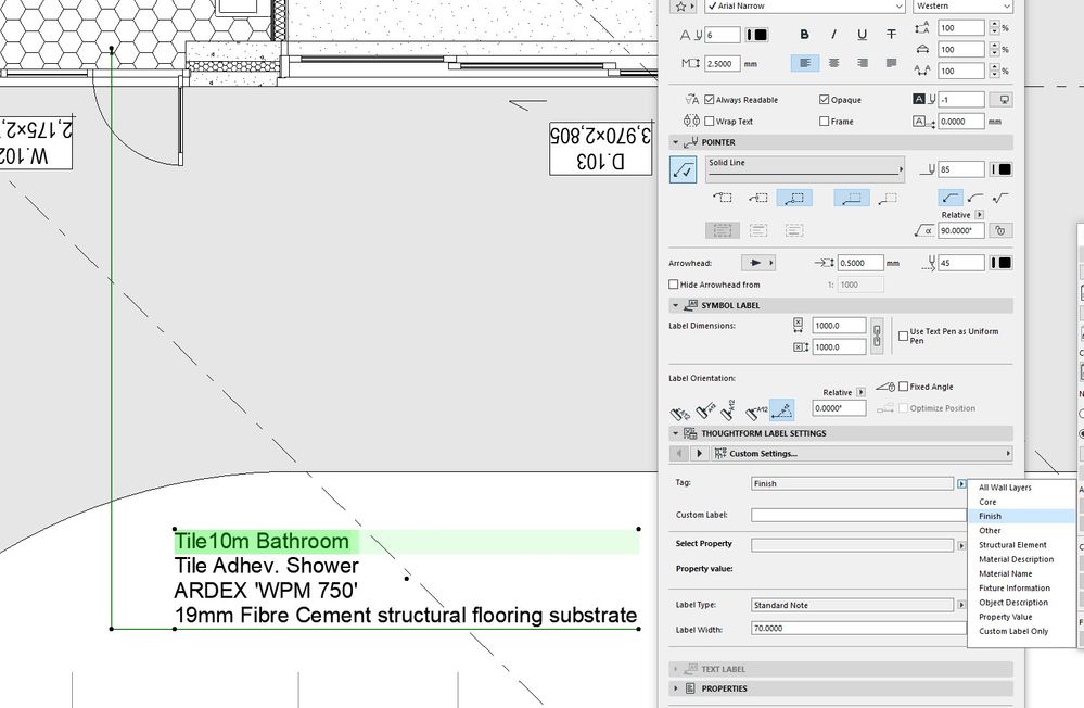

I've developed a label that will list the material description of a composite wall/floor/roof with the options of either listing:
1) all the skins or,
2) only the 'Core' skins or,
3) only the 'Finish' skins or,
4) only the 'Other' skins or,
5) the ID and name of complex profiles,
The label also has some other options that relate to properties I created.
The workflow is: I build up a library of materials that has all the important information in the description, I then use these materials in the composite walls and as fills in the details. I can use the one label to pull the same information from both the live model and 2D details.
It doesn't have the option to select the material description of a single skin, unless there is only one skin in the Core/Finish/Other category. I'm sure you could edit the code to develop this functionality.
If you're interested, I could upload a copy of the label.
