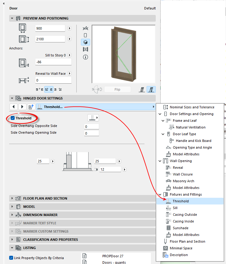

Have you tried the option for 'Threshold'?
Or 'Sill' which is a little different and not exactly what you want I don't think.

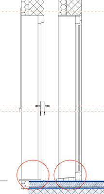

With the door tool, I only have a frame at the top, even I use a threshold. But if I use the window tool it's ok but it's less appropriate. And I think it's possible to have a lower frame with the door tool.
At the left it's the door with the door tool and at the right the ''door'' with the window tool.

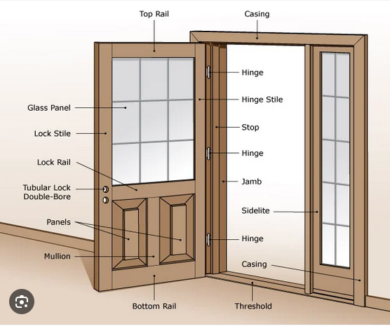

A hinged door does not usually have a frame at the bottom, just the threshold or sill, which is usually quite low.
The door leaf itself can have a frame.
Is that what you are expecting to see?

I have never seen a frame at the bottom of a door frame (except for a sliding door).
If you want me to leave this wish open, I will, and maybe one day you can have the option for a bottom frame.
Otherwise if you are happy that there is just the threshold, I will close the wish.

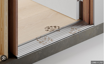

For me a metal or timber threshold (like this), but not an actual frame.
