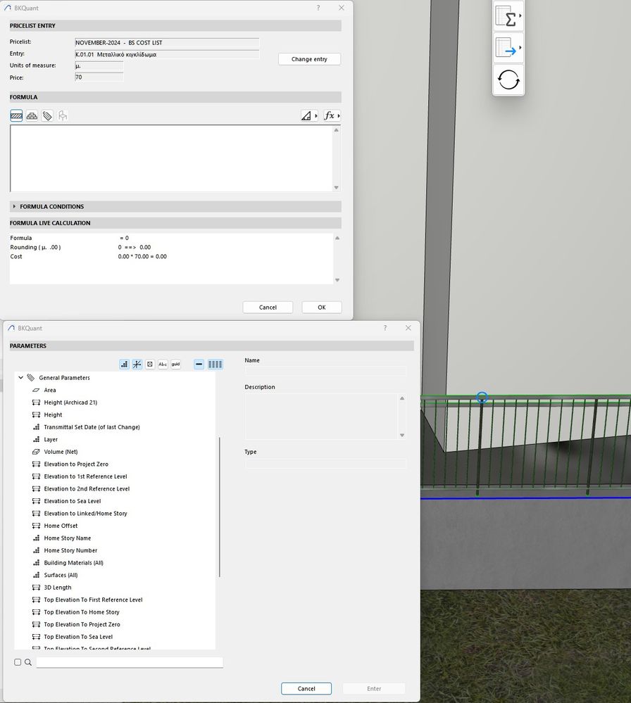

Hi to all, I don't know if you are aware that Archiquant plus is rereleased as BIMKit Quant !!!!!!!!!
https://community.graphisoft.com/t5/General-discussions/Finally-Realtime-Cost-Calculation-and-Quanti...
Somehow this wish has to be changed to "Delivered"
I can change the wish to delivered, but before I do...

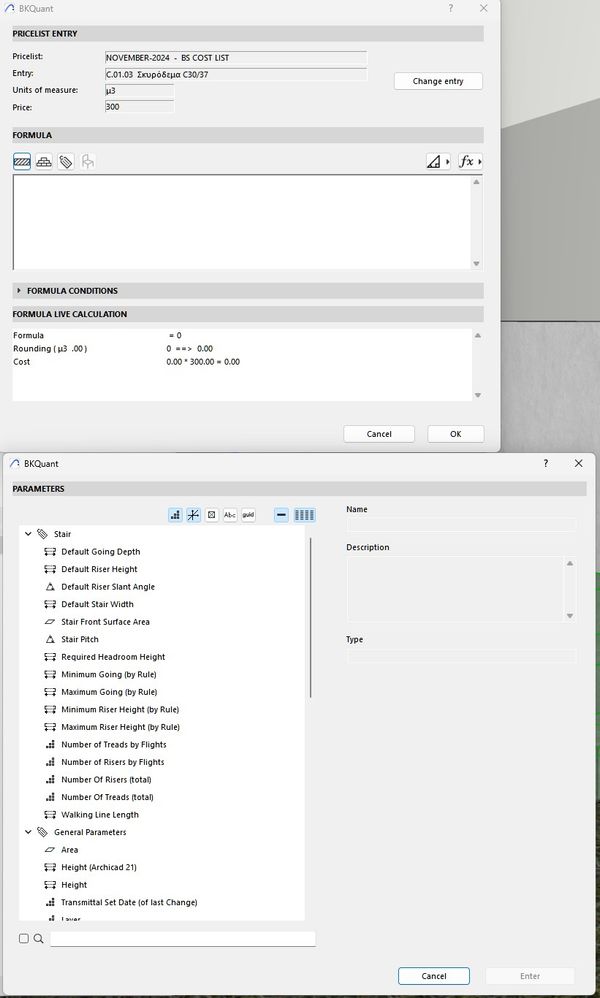

Do you know if it handles stair and railing components, beam and column segments? - as the old list schemes do not.
Also, I do not see curtain walls and can it handle multi-plane roofs or do they have to be split (which is easy to do).
And I assume openings (with the opening tool) are just deducted from elements (as door and window holes are) as they seem to not be included either.
Watching the video it does not seem to say and only shows these elements.
Botonis
Mentor
Hi @Barry Kelly
All are included, curtain walls, multiplane roofs, railings,openings,stairs.
Check the video with the instant change of cost when adding-removing an opening.
https://jumpshare.com/s/6UmSnRnqkXDWjSFFnrLO
The link will expire....No permission to upload videos......
There was a discusion during beta about multi segmented beams-columns and the team is trying to optimize that.
