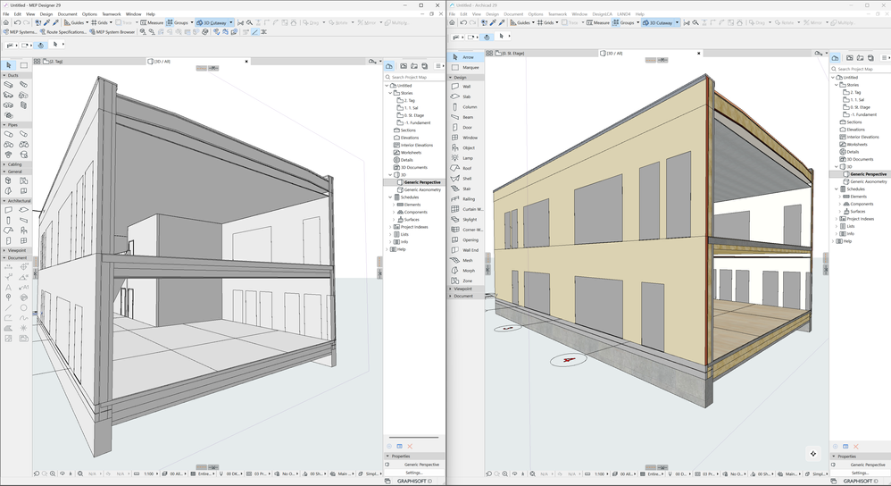

Can you also post a screenshot so it is easier to see how the hotlinked IFC looks like in Archicad?
By the way, if you open the IFC file in a free IFC Model Viewer, are the colors there and they are lost in Archicad, or they are not there even in the IFC file?

Hi Lazlo.
The issue is the MEP engineer working in MEP designer, and finding it limiting not to be able to the difference in the components visually, as they are all white!
Below is a screenshot, showing MEP Deisgner (left) and AC 29 (right) with the same IFC added as a Hotlink.  This, however is just a very simple demo project..

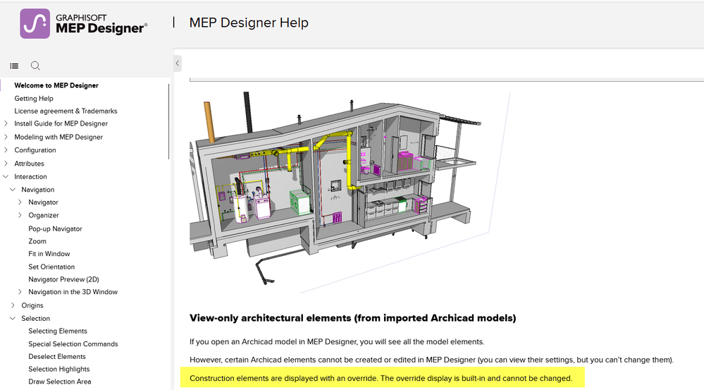

Isn't MEP Designer just for designing the MEP elements?
The Architectural model is not what you are focussing on.
I found this in the MEP Designer help file.

You´re absolutely right Barry.
However, when adding an Architectural /Constructural IFC inte MEP Designer, it is very hard to tell the difference between the Building Materials...
So, as our client stated; Where can I place the ducts, where can i mount the piping for the sprinkler, and in what space can I place my cable carrier...
Piping could be placed inside the wall in the insulation layer, but what layer is that?
The Buidling Material Air (if added as a skin in a Composite) could also just be shown with a white Surface, so where to fit the ducts above the ceiling. (see my picture above)
I know a lot of this could taken care of in a BIM protocol, but in many cases reality is far from that organized...
Bottomline: Our potential MEP Designer clients are flagging the issue, that most likely this will be a drawback, when collaborating with other BIM consultants...
Hope my point makes sense! 🙂
