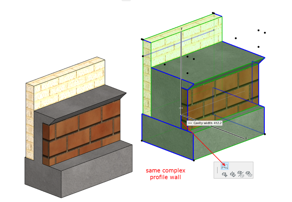

Complex profile walls with modifiers for the skin width are exactly what you need.
TaniavH
No, like I mentioned,  we do not want to have to use Complex Profile walls - we have tested this workflow extensively and they are far too cumbersome for the average user as well as far too time consuming. We need something fast and efficient, without the need to create profiles. Graphic representation alone makes them not a suitable option.
