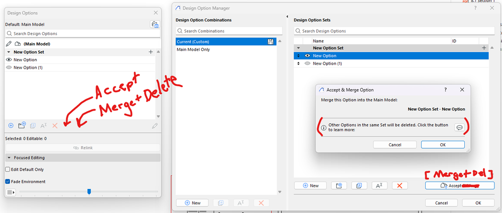

1. Accept and Merge to be added to the Design Option Palette
    - You have no idea how annoying it is to open the Design Option Manager for this one option. (Leave the Design Option Manager for the combination views)
2. Merge only option
    - Don't delete other merged items in a subset. I'm creating many subsets with only one item because I might need that option in the future.

2 Comments
James B
Thanks for the feedback, when you delete an option, you can choose to move those elements to the main model (in reference to your point 2).
In AC28, we added many management functions to the palette. And planned for next year, we are working on extensive API support for design options as well.
Pato99
Thanks for the reply, that's not exactly what I meant.
EDIT: I see what your saying for Point 2, instead of merging the option you want in the main model, "delete" it and you get the option to link it to the main model.
Bit of a round-about way, but it works!
There should be "Merge" (Accept) and "Merge and delete" options in both panels, thanks!
