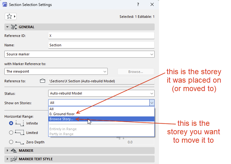

Please add a setting to see/ set/ update the home storey without playing around with the show on storeys

Does the "Browse Storey" option do what you want?
If so I will close the wish.
DamianW
It does, but my wish is to make it easier for staff to find and understand markers (deleting storeys, using iceberg models, interior design documentation on negative levels, etc.) - really hard to explain to staff that's how you edit the home storey given all other tools have it explicitly stated. Not to mention that there's a browse storey here also:
I thought this could be an 'easy win'.
