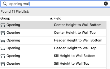

Hey
I need the properties identical to the ones that is available for Opening objects as in the list below, to be available for Windows and Doors.
Or does it already exist in Acad 27?
Operating system used: Mac Apple Silicon 14 Sonoma

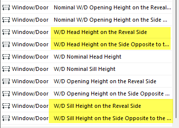

Kamelite
They do exist in Archicad 27, under door and windows in the native propertylist.
.Kamelite
No, we only have the head and sill height from the base of the wall for doors and windows.
Nominal head and sill heights will take reveal geometry into consideration as well.
The are no door/window heights from the center and nothing measured to the wall top.
Openings can also be measured from Home Storey or Project Zero, which doors and windows can't.
jorGKX
Hey
I need the properties identical to the ones that is available for Opening objects as in the list below, to be available for Windows and Doors, at least the "header height to top wall"-property.
This feature was requested a while back, and added to the backlog (as of my understanding), but in Acad 28 it is still not available.
PLEASE MAKE THIS, WOULD SAVE ME A TON OF TIME
