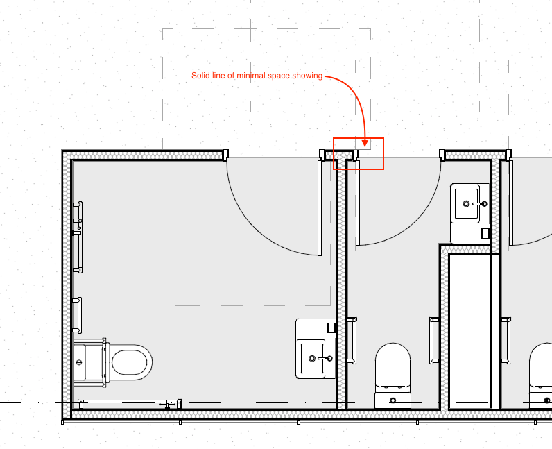

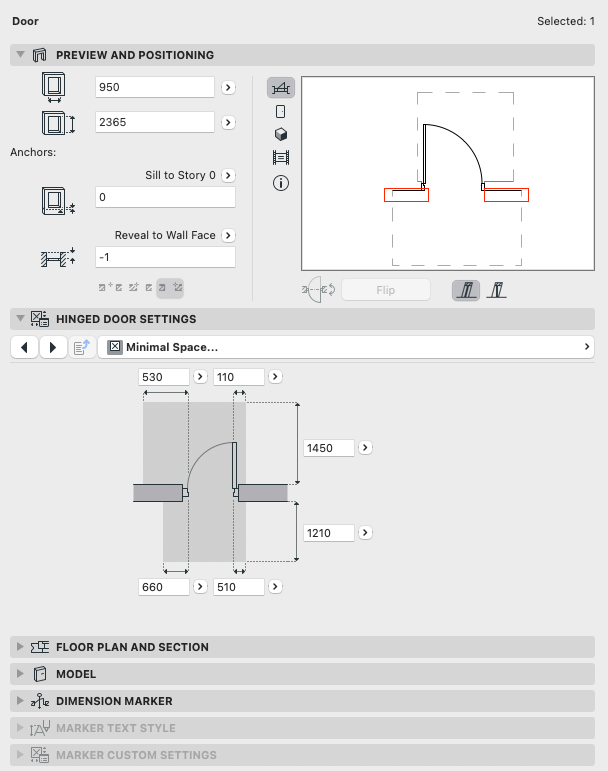

Minimal space for statutory clearance around doors is a great feature, however there is a solid line displaying against wall when minimal space is turned on.

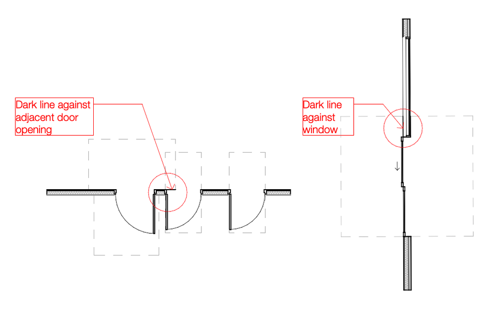

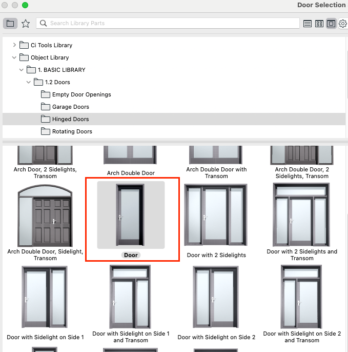

This is not generally an issue unless there are two doors next to each other, which then exposes the solid line. I have tested this on a number of basic standard library doors and it occurs in all instances. Graphisoft have indicated the same lineweight issue exists in ArchiCAD 27 & 28.
The issue is due to a limitation of the Minimal Space feature and it occurs because minimal spaces for doors are aligned with the length of the wall.
I wish the display of line weights and their location were more flexible within the Minimal Space feature.
On the attached I have highlighted the section solid line that I would like to remove.
