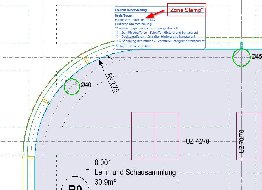

One of many examples: We often use lines as zone boundaries - on the same layer as the zones, to keep things compact.
But we don't want to see them on the floor plan, so we struggle with GOs and 'dotted lines with ultralarge distance'. But this fails on curves.
The wish @James B mentioned (link is broken) is another part to free us subjugated users...

No, we hardly ever have edges turned on for zones, we won't get rid of them (because there is no GO with 'Pen 0' yet).
But we often (have to) use simple lines (line/polyline/arc tool) as a boundary for 'automatic' zones to keep things 'semi automatic'.
The facade tool produces polygonal zone boundaries, profiles and panels so we use it for vertical elements only.
But we need a zone boundary, so it's an arc, on the same layer as the zones:
I can see this being a valid issue.
You need the line there to control the zone, but you don't want to see the line.
The same if you want to split a room into two zones without having a physical line, which might look like a change in floor finish when there isn't one.
