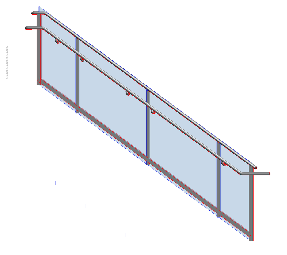

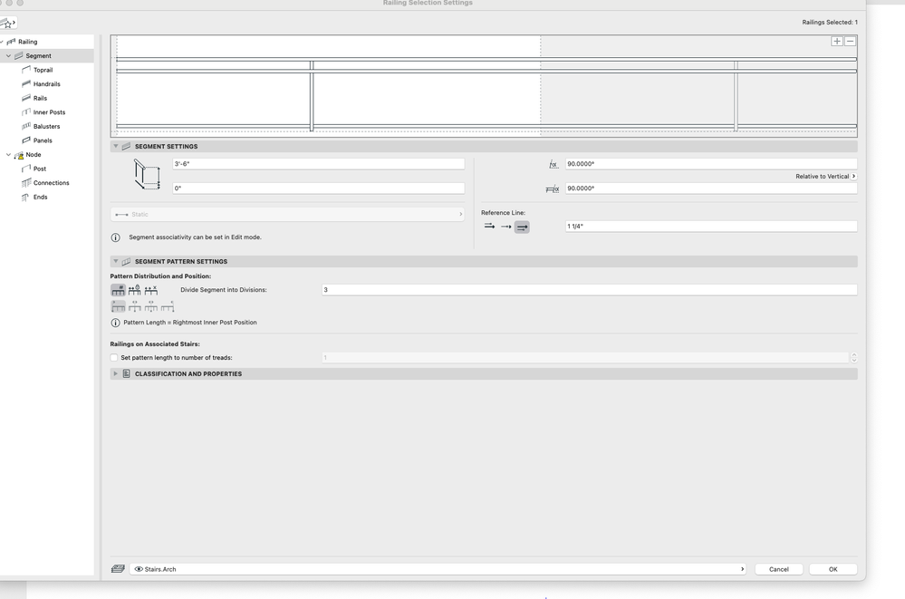

The railing tool is absolutely horrible and overly complicated. When I try to change segments, the result is not what I'm looking at in the settings. Please for the love of God and baby Jesus, do something! I waste more time trying to model railings with the railing tool when I can model it using the column and beam tools in no time. I can't for the life of me figure why the pattern distribution and position does not work when I simply want three divisions. It will spit out extra posts for no reason whatsoever. And why can't adjust the segment length? It just exists all by itself in the preview window without being able to click on it.

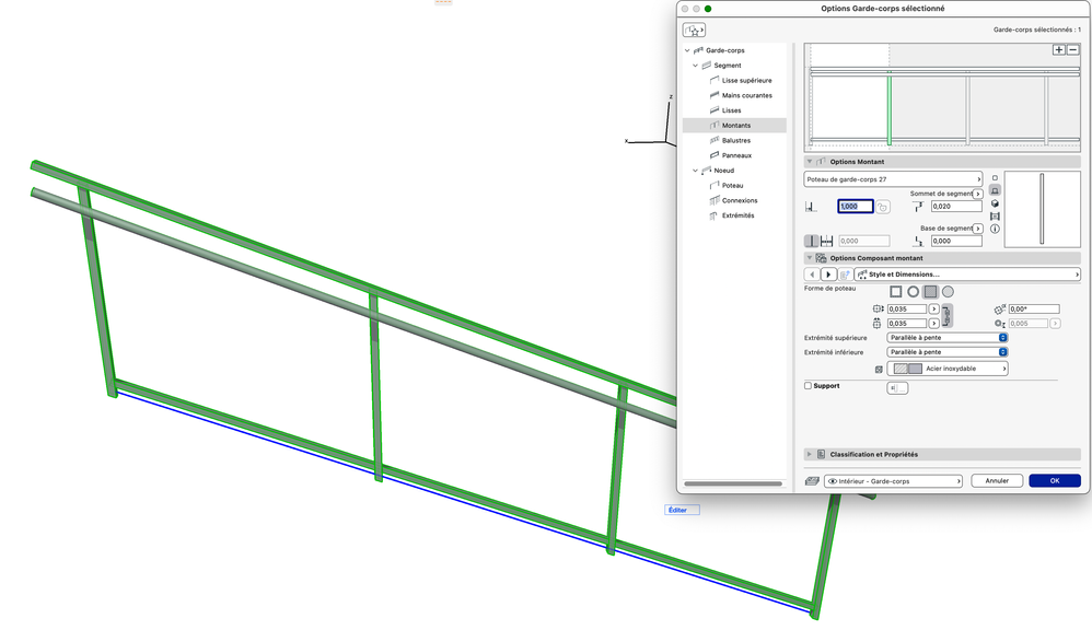

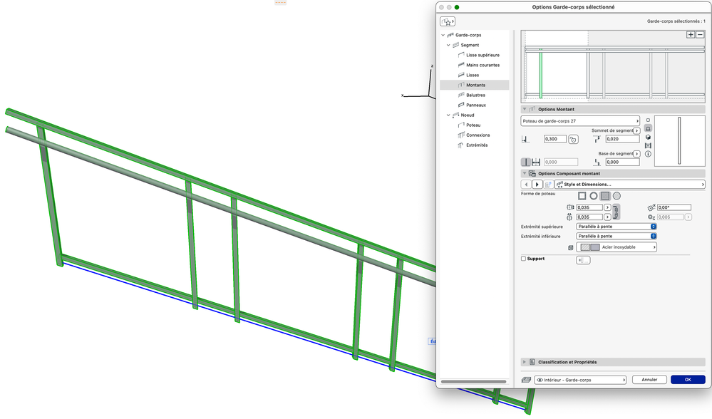

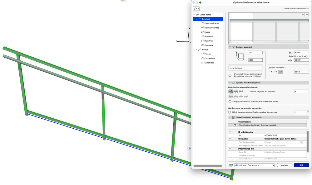

The length of the pattern can be adjusted at the railing post level; you can also place multiple posts within the pattern.
This is the pattern that will then be distributed across your segments.
Is this what you were looking for?
