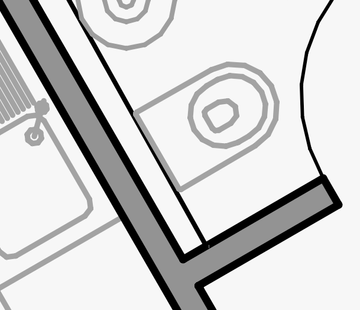

Archicad is still approximatinmg Arcs (from Polylines) with short line segments in its PDF output.

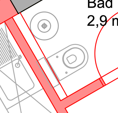

The help falsely claims it would not be possible in general, but lo and behold:
That's a PDF. Exported from Allplan 2008 (!).
So it is possible.
Pure, vile, ugliness ensured in AC with polylines:
After investigating I found out that this is ONLY an issue with polylines. GDL objects and circles are not affected.
Also: It is a crime that 3D Arcs are already angular-shaped in Archicad instead of nicely round and smooth.
Looking at you, Profiles and Shells!

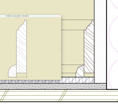

I was just going to post a wish about curves in Complex Profiles. I will upvote your wish instead and hope CPs are included. The crudeness of the curve resolution in CPs is just awful, especially when using them for detail-level modeling where close-up views are required.
