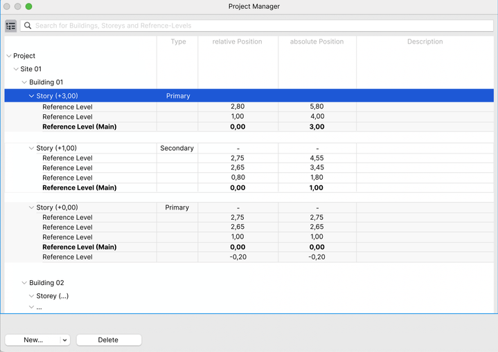

Hey everyone, I´ll do some UI sketches of the possible implementation that hmartell mentioned with some additions to comply with the IFC Data Schema. To expand on this I would introduce a Site level aswell. The hierarchy would be like this:
Site > Buildings > Storeys > Refrence Levels
Here´s my quick UI sketch of how it could be implemented inside the Archicad ecosystem. Note: This variant is fully IFC data scheme compliant and provides great flexibility while still preserving the simplicity for the architect that doesn´t want to tinker with reference planes (by choosing a story directly the system knows to pick the main reference plan if no other reference plane was selected)
This is the active Story Settings.
This is my suggestion (open for Feedback and improvements) for managing Sites, Buildings, Stories, and Reference Layers.
And this is my suggested implementation in the Wall tool for example. Pretty much the same concept inside the Slab tool, beam, column, everywhere really...
The red arrow means: "by choosing a story directly the system knows to pick the main reference plan if no other reference plane was selected"
Implementation within the Floorplan Views:
Each Floorplan belongs to a Story, which belongs to a building, which belongs to a Site. The current system of "Show on Stories" requires somewhat a vertical structure of the Stories and doesn´t really take Split-levels or Split-stories into consideration. That´s exactly why the Parameter "Type" within the Table (second Screenshot) is for. "Primary" means in will be taken into account when the system needs to decide what will be affected by "Show on Stories", and "Secondary" means the system will not take that Story into account when dealing with "Show on Stories".
All Stories are exported as IFC Elements, all Reference Levels are not exported in any 3D way or form.
Thanks for reading this through, I hope I summarized the ideas of everyone in this design. And yes I know that this is not perfect, I'm quite aware of some edge cases actually, but I decided that Graphisoft will take care of those further on (hopefully haha). I´m always open to feedback and suggestions, thanks in advance!
Cheers!

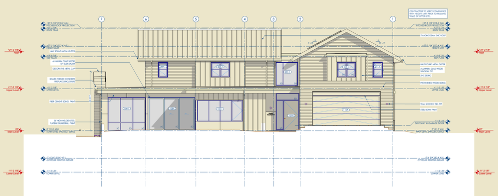

SeaGeoff
Ace
Great work @Christian Muntean . This is a much better reflection of what we all deal with on real projects than what we have now.
I will add one obvious point if I may, which is the need for good graphic marker options and corresponding data. Many of the Reference Levels I establish are neither Stories nor controls for element heights, but rather datum or limits necessitated by permitting agencies, like Average Exiting Grade and Height Limit. In this case I do not need to access these levels within tool settings, but I do need to show them consistently in elevations and building sections.
In the example below all the level markers are custom objects that report their vertical location but are not otherwise connected to any project-wide data. I improved this system by creating a 3D reference plane object that can then share its properties with labels placed in the S/E viewpoints. This helps keeps things coordinated across drawings but is still tedious to setup and maintain. Your concept would take this a step further if a Reference Level could optionally display a marker in any S/E view, similar to a gridline.
Thank you @Pedro Melo, I knew these questions would arise. I just forgot to add them to my previous post. That complexity is although only theoretically there, because if you draw a Wall within the ground floor, the system knows exactly which ground floor you are inside, therefore knows what story is linked to that Floor plan, therefore knows the building the Story is within, and therefore knows the Site. By that Archicad would automatically insert those Values into the property of the drawn item.
Drawing within 3D Viewports is a Edgecase for this usecase. For this new system, when drawing in the 3D Viewport you would always have to specify the building and choose the Storey within the Wall/Slab.
Or you could maybe have a default "Active Building" button where you can switch the active Building you would want to draw inside. This "active Building" could look like this:
So as long as "Building 01" is selected, everything you draw in that Floor Plan will be within "Building 01", which is within "Site 01". You would only have to select a Building, not a Site. A Building is within a Site and therefore knows where it belongs to.
For Architects that DO NOT want this added complexity they would only have one site with one building. If that is the case then the system would always insert that building (which is inside that one site) as a default, because well.. there is no other building to insert. The architect that wants it simple doesn´t have to do anything else. He can still use the good old system with only Stories (= Main Refrence Levels) for only one Building and one Site.
For Architects that DO want this added complexity there is that Dropdown on the bottom of each View where they can select the "active Building" they want to model the Walls/Slabs into. And there is always the option to go into the Element itself (Wall/Slab) and change its Building within the Properties (Screenshot from previous message)
