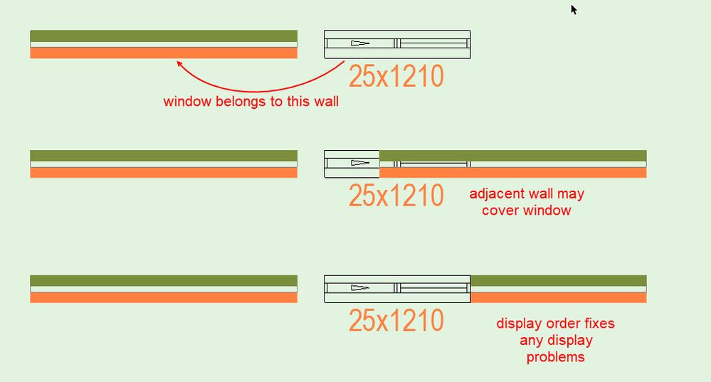

I am not quite sure what you mean by "invisible in plan".
Do you mean it is covered by another wall?
A window can be moved so it is not in the wall at all and can still be seen in plan and 3D.
If you place a window in a wall and then spit the wall, the window will only belong to one of the walls.
Depending on how you do the split, the adjacent wall could cover the window.
But then it is just a display order issue to fix it.
Below I have moved the window outside of the wall to show that it is still there.
Placing an adjacent wall may cover the window.
Using the 'Split' command usually sets the split of wall that does not host the window automatically behind so display order should not be an issue.
Maybe you can show an example of what you are doing?

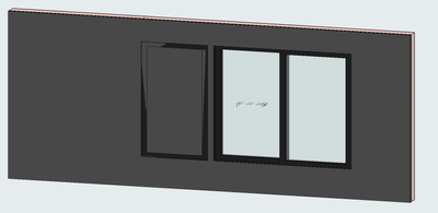

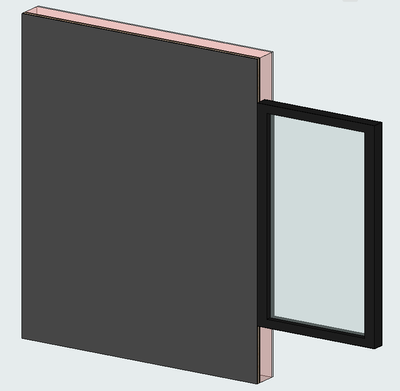

Stacking order only works like your screenshot if you have fills active on the windows - which we find unnecessary in general - if you don't, you see both the window as well as the adjacent wall...(You also have to consider less experienced AC users, who don't automatically consider display order, especially when working quickly.) It looks like if the window frame edge is exactly aligned with the endpoint of its associated wall but is outside the wall, AC sometimes forgets which wall it's actually in and you get the result like the screen shots below. Moving it away and then back again works like a graphic reset - but if it's being covered by the adjacent wall, people assume it's just gone and then place a second window on top.
Having a highlight check for this type of scenario will be useful for checking model accuracy - perhaps something similar to the highlight inverted elements feature...?

If you are splitting a wall, the window will remain associated to only one wall, as you know.
When I split the wall within the window area, I get a second window, one in each wall - that does not seem to be what you are doing
When I split the wall exactly at the end of the window, or slightly outside, the window will remain entirely within one wall only.
I am unable to get the window to belong outside of the wall unless I drag it there myself.
So, I am unsure how you are breaking the wall and getting the window to be associated to the wall it is no longer within - i.e. outside of the wall entirely.
If you then move (drag) that window across between to co-planar walls, it will automatically associate with the wall that it is entirely within, as I think you know as well.
I am assuming when you break the wall that you are using the split tool?
In my testing, I am unable to split the wall and have the window associate outside of the wall.
I am not taking away from your wish, I just don't understand how it is happening for you.
