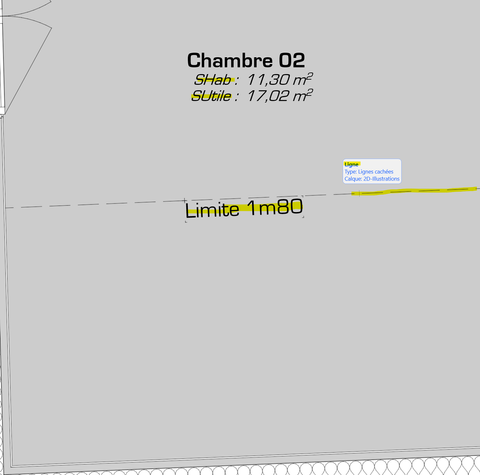

When modelling volumes under a roof or within a sloping ceiling, we subtract the areas below a certain height (1.80 metres or 1 metre, for example).
It is necessary to indicate where the boundary lies between areas below 1.80 metres in height and those above (in France, for floor area), and this currently has to be done manually using a line and text, by estimating or measuring this boundary on a cross-section.
It would be useful to have an automatic line drawn across the areas where an area calculation has been defined. This line would therefore be linked to the area calculation defined for each zone and would allow for a precise and clear visual representation.

I don't know if i fully understand your wish but it is already possible to project a line on the floorplan with: "create roof level lines...". This is however a line that has no link with the slope of the roof. If the roof angle changes you must delete the line and create a new one. Also the zone's have to be done manually. This could be a good wish if thinks are connected and update automaticaly in case of a change.

This tool does exist, but as noted, it is not linked to or triggered automatically when the roof is changed. It remains a 2D solution and is not very “practical.”
Linking this to zones would allow for automatic management (when Boolean operations are performed) of this feature in relation to the defined height. Zones perform automatic calculations, represent volumes, and interact with the desired objects (including roofs). This would be the most practical and “accurate” approach.

Also, there are countries that have quite complex calculations for areas considering coefficients for different heights. It would be great if you could define different levels within the dialog box (and not be limited in number of those levels!) and then automatically draw outlines of them on plans, and have those outlines have hotspots so they could be dimensionable.
