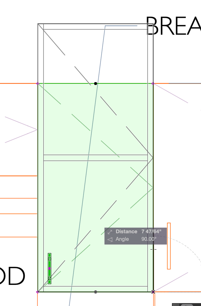

Here is the problem: when placing cabinets, they come with a lot of nodes. There are nodes that allow you to stretch the cabinet height, which when stretching from the top does just what you'd expect - it fixes the bottom of the cabinet and stretches the cabinet upward or downward from there. BUT! When you try and stretch the bottom of the cabinet, the whole things gets weird. The top starts to move, and nothing works as you'd want or expect. (In the screenshot, you can see I have clicked on the bottom corner in elevation, but the top is stretching.)
A novel solution: have the bottom stretch on cabinets fix the top point and allow you to stretch the cabinet bottom up or down.
Has anyone else encountered this issue?
