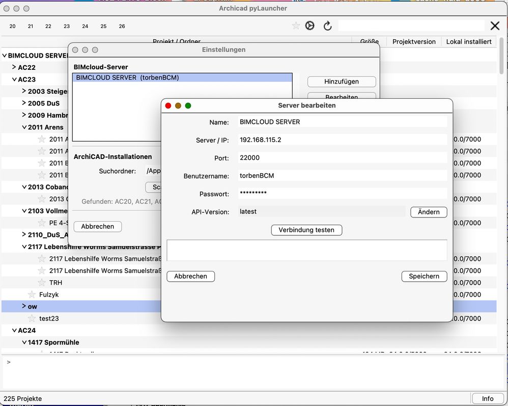

You mean something like an Explorer-Window or a Finder-Window from where you can start every project that is hostet on your server(s) with a single double click? With the right Archicad version?
Well, I made myself an universal BIMCLOUD-Launcher for macos and windows. Just send me a pm and I'll send it to you, if you like.
But I will first have to translate it.

Nope. A shortcut that you can open a TW project from that sits within the same filing system as your non-TW projects, consultant receivables and post-production files.
Your launcher does look great though if all of your projects are TW and across multiple versions.

A simple shortcut will not work, because you need to authenticate against the bimcloud-server. My tool does exactly what you ask for: it creates a command that starts Archicad with a command line parameter which includes the authentication of the registered user. But the credentials are sent in plain text. This is all handled inside the software for that there is only minimal security risk. Maybe it’s possible but not as a link or an alias but as a script which pulls the credentials from the local preferences or registry …
let me think about it …
