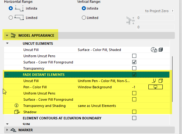

A useful hand-drawn and 2D CAD technique is to have a thick line around edges of elements which are in front of another. In ArchiCAD I would like this feature to help give depth to elevations, without having to manually trace. For instance, a wall can have an uncut line type but there is no difference to a line indicating a wall opening or change in material, to a line which is the edge of a wall. I imagine this would be a check box in elevation settings along with shadows, transparency, etc, and a line type chosen as the 'thick' line. There may also need to be a threshold depending on how such a feature is processed.
3 Comments
Have you explored 'Fade Distant Elements' in the elevation/section settings.
It automatically reduces the line thickness of element in the distant range.
DMP33
Hi Barry,
Yes, Fade Distant Elements is useful for things further away, but it's more the outline of closer elements which I'd usually like to be thicker.
Yes, you use thicker pens in a "thick"pen set and then fade what is in the distance.
But you can't control the lines of individual elements unless you alter the settings for those elements.
