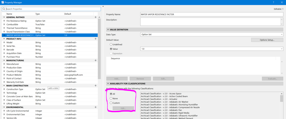

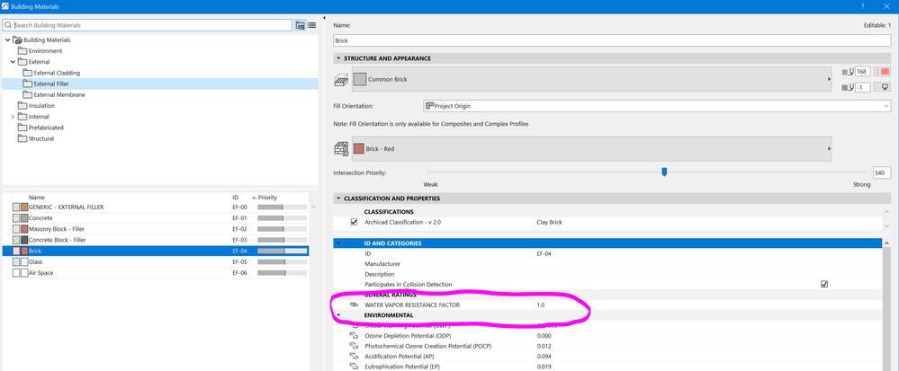

JeffH
You can create General Properties under the Properties and Classifications.
as long as you have them set up to read all of the classifications that your building materials are set to, they will be available within the Building Material Dialog.
