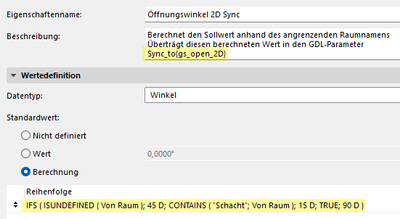

But: It's possible to control the opening angle with expression based properties and the help of @kuvbur 's 'SomeStuff' addon.
This may be nothing for the faint-hearted, but it shows what would be possible if GS would really care about (my) wishes. 🤣
We use to open the doors of utility rooms only by 15° to show that they are seldomly used.
This one looks for the zone name "Schacht", and the 'Sync_to' statement in the description tells the addon to set the lib object's parameter 'gs_open_2d' to the calculated value.
